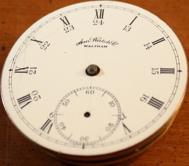

This is my first attempt at removing a dial. this one is lifting until I get to the 16 and 20 positions. Between the two at the bottom it appears to be attached with some kind of adhesive.Any suggestions? It is tight to the movement and doesn't want to budge.

If you have the screws loosened, use something thin and wide, like a razor blade, look though the gap between dial and movement and lever apart carefully working round raising slowly (set the blade in a little way to lesson chance of dial edge chip), sometimes if a dial foot is missing a dial dot maybe found, to stop it rattling and these are non destructive sickly pad. You may well find if it is that can be reused again!..

Thanks Chris that worked with only a small chip that I caused. I think it went well for a first time. What is used for soaking and what is used to fill in chips. Some would say all my screws are loose.
