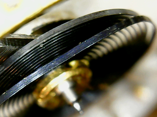

so, this is my problem, i installed the balance before the fourth and escapement wheel, and pallet so i could look in and check that i was in beat. what i found was that i was in beat but if i gave the balance a slight spin left or right it doesn't come back to being in beat. first thing i thought was bad or broken pinion. so i pulled out the balance and the pinions look ok to me.

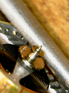

Todd Verriere
other side looks ok too

so next i think hairspring problem, looked at that and it looks ok too.
but i wanted to isolate the problem so i removed the hairspring from the balance and put it back in the movement without the hairspring.
it moves freely and smooth as silk, very little shake in any direction. much better than with the spring in place.
so i reinstalled the spring and back into the movement without the stud in the balance cock. smooth as silk again.
as soon as i put the stud into the balance cock, sluggish again.
is it possible the hairspring stud is twisting the spring in some way causing it to rub somewhere i can't see?
could this be causing the sluggishness in the balance or is there another possible cause?

i think i found the problem,
the overcoil seems to be bent too much towards the cock.
it arcs up then back down to the stud. other hairsprings i have don't look like this.
i think it is rubbing on the bottom of the cock where i cant see it.

Todd,
Welcome to the world of hair springs. Sometimes, there is a slight bend right where the hair spring enters the stud. The stud should be dead vertical when the spring is sitting on the table. If it is bent off vertical, when you secure it to the balance cock, it will flex the over coil up or down and cause it to drag on the other coils or on the bottom of the balance cock.
When the stud is secured to the balance cock, most assemblies finish with the stud perfectly flush to the top of the balance cock. If the stud is set too deep (remember you are coming bottom up... so it will be exposed on top) This will move the over coil up and make contact with the bottom of the balance cock... try pushing the stud back down toward the hairsping a fraction of a millimeter deeper in the socket and see what you get.
This is much easier to correct and much more likely to be the culprit than a misbent over coil.
I take a measurement from the center of the upper jewel in the balance cock to the center of the mounting hole for the stud... then I measure from the center of the hairspring to the stud.. these two measurements need to be a dead match... if the measurement on the hair spring is larger, it will flex the coils to the left... if the measurement is smaller... it will flex the coils to the right... It changes the geometry of the entire coil causing them to either sister up or to drag.
