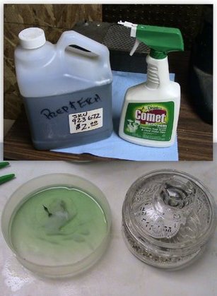

Ernie LogaI have soaked dials in Comet Bathroom Cleaner and the result was great. I also just sprayed the dial with the comet and let it sit and resprayed a few hours later. I got the same result. then I had a watch with several cracks and I was too lazy to take the dial off the watch. I used a cotton swab and lightly placed the cleaner on the cracks and let it stand. I retreated it twice and the results were also great. However, you need to be careful you don't over do it so you get liquid into the watch. Just use small amounts and dab it.

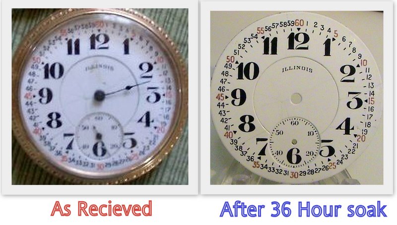

Bruce StewartWhen I first heard about Comet cleanser I was pretty excited about cleaning one of my Illinois Stewart dials. Because the dial was pretty rare, I decided to do a test run on a junk dial to see how the Comet worked. It worked great! Just to be safe, I did 3 more test dials over a period of 3 days to confirm the results on the first dial. Same results -- excellent. Each test was done overnight. After all of my testing, I finally had the confidence to clean my precious Illinois 18s Stewart dial. I put it in the cleaner, went to bed, and got up in the morning all excited and anxious to see my newly cleaned dial. To my horror, everything had faded on the main part of the dial. The only thing that had remained black were the graphics in the small subdial. I was depressed for several days. Now when I use Comet, I check the dial every hour, and try not to leave it in the solution for more than 5 or 6 hours max. Just thought I would share my hard learned lesson with fellow club members -- anybody got any Stewart dials they want to sell :-)

David AbbeAfter cleaning several hundred dials with and without "Comet" (after learning the hard way to find other methods) I follow a couple basic rules;
A. WHEN NOT TO USE COMET;
1. If the seconds chapter is held in by
ANYTHING other than lead-solder, clean the dial face only and very carefully without any pressure on the seconds chapter.
2. If the dial is already fairly "pristine", wash and brush only, no "Comet" needed.
3. If the dial is very early (from Key-Wind Mvt's, pinned foot types etc.), it is 90% likely to be hand-marked and inscribed. Use mild (ivory) soap, warm water, and gently clean it with your fingers.
4. Metal Dials;
a. Silver or Silver-Plated, use "Elenar" Silver cleaner dip(rinse and check dial every 30 sec or so), it brightens the silver without taking off the enamel.
b. Other metals, I hand clean with soap and water and hope for the best.
WHEN USING COMET CLEANER;
1. Using Comet, Max immersion time; 3 hours.
2. After 1 hour, rinse, inspect and (if needed) re-spray "hairlines" and let soak.
3. When finished, always use a well worn toothbrush and detergent to brush/rinse both sides of the dial face.
Also I use Green Concrete Driveway cleaner (from Home Depot, Paint dept.) to "de-rust" watch hands. It cleans good hands completely so they can be polished and re-blued, and the overly rusted hande disappear. (soak no longer than 20 minutes).

Bruce StewartTo answer Ernies question, yes the Stewart dial was an original. There would be no money to be made in reproducing the dial of a private label watch like this that doesn't have a very big following (I may be the only fool out there collecting these things, LOL). The one comment I forgot to make in my first posting is if this happened to my Illinois Stewart, it could be that all Illinois private label watch dials are just as fragile. I would imagine they were all made in the same manner from the same facility. I think what they must have done is fired part of the dial as enamel or porcelain, then silk-screen on the private label name, thus the differing reaction to the cleanser. The next time I do one of my Stewarts I will be applying the Comet only to the cracks to start. I plan to apply the solution with an artist brush (avoiding chapter markings, etc.), then set the dial face up in a jar on top of a wet sponge, then cap the jar. With the high humidity from the sponge, the Comet should stay wet for a long time, rather than drying out. Every hour or so I will get a visual through the glass to see if the cracks are disappearing. After the cracks are clean, I will probably give the whole dial a one hour soak directly in the Comet. After that it will just be a rinse and pat dry (I'm too paranoid to use a dryer, even on low setting). I haven't tried the above method yet, but will report back after my first attempt.

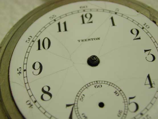

Roland GlennGreat thread!!! I can't find this type of liquid Comet up here in Toronto, so I'm trying Scrub Free liquid cleaner that has NO Bleach. I've got a Trenton dial from a model 3 18s convertible that I've had soaking for about an hour now and it's a slight bit cleaner, so will post results tomorrow on this brand of cleaner. Here's the dial before cleaning. Many, many hairlines. I chose this dial to clean as I have a mint 1891 Trenton dial on the way to replace this, so figured lets try and if it comes clean great, if not then oh well.
Thanks, Roland.
 R. Glenn

Roland GlennHi Dave, forgot all about checking Wally's World. Well here's an update on this cleaning product after 4 1/2 of soaking. I can still see the larger hairlines, and if I had left it over night I'm sure it would have cleaned them all out, but at this time when I went to check I noticed the black numerals starting to fade so I pulled it out. So is this Scrub Free the stuff to use? Not sure and at this time don't have another donor dial to experiment with. Here's what the dial looks like after the short 4 1/2 hrs of soaking.
Thank you, Roland.
 R. Glenn

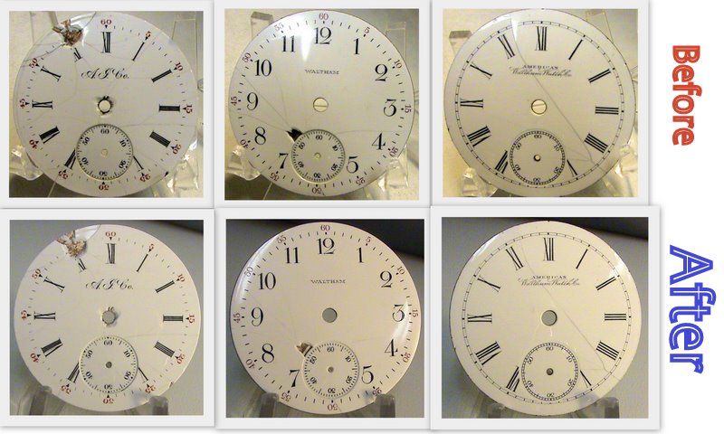

David AbbeDial Cleaning 101A
After "much study" of the articles (so far) we have posted for this important subject, I decided to embark on my own little "experiment". First, I consulted my Dentist about the fast (5 minute?) cleanser and was told sharply Be Careful! As for the overnight stuff, he said that was very good for dentures and might work well for this if the stains are much the same organic stuff. So I got some to "experiment" with . . .
December 13, 2010, 21:11
David AbbeFirst, I tried a three hour "soak" of some "so-so" dials from the dial stash . . .
The results were much better for superficial cracking than for deep structural cracking. These are being re-soaked now for 36 hours after seeing what it did . . .
David Abbe. . . on a very fine Restoration Project Bunn dial that looked like it was "pole-axed" near the center, a 36 Hour Polident (only) "soak" made it 98% GONE!. (Sorry I did not have a better "before" picture.) The extra good news is there seems to be no "bleaching" of the red dyes. More on this soon . . . .
