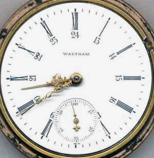

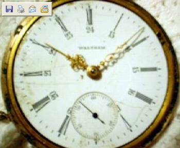

I know this is an old subject, but I wanted to show how well Polident cleans hairlines out of dials. The "before" picture is a little poor as it was from the e-Bay listing of the watch. The second picture is after overnight soaking in Polident with warm water (to start). I haven't cleaned the case yet, so please ignore the grime
Grant Perry
August 12, 2005, 20:49
Grant PerryAfter.. I'm sure some people are going to think I replaced the dial, but there is still 1 hairline visable between IIII and V. Same dial

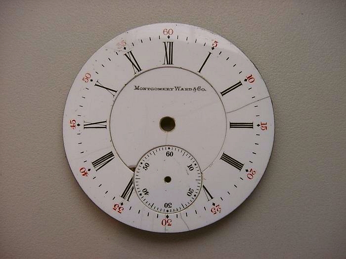

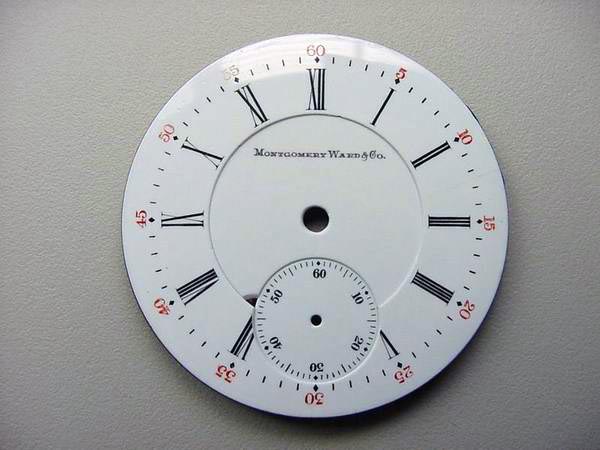

Since I opened my trap and touted the use of Comet Bathroom Cleaner, I thought I would put my $1.99 where my mouth is. The dial you see below is off of my 17 Montgomery Ward thin model. As you can see there are several hairlines and a chip. I placed the dial in the comet solution upside down in a bowl. I placed it on top of the fridge, and will lightly brush with an old tooth brush in about 2-3 hours (just rubbing your finger over the top of the hairlines seems to work well also.
I will post another picture when the dial is done. I started the soaking at 0900 pst
Bruce Byrd
THIS IS BEFORE:August 21, 2005, 19:00
Bruce ByrdHere is the dial that I posted earlier today. As you can see, the hairline between the 2 and the 3 is barely visible. I brushed it once with a soft bristle brush. Once it was finished soaking, I cleaned it with dish soap and dried it with a old t-shirt.
AND THIS IS AFTER:August 29, 2005, 14:57

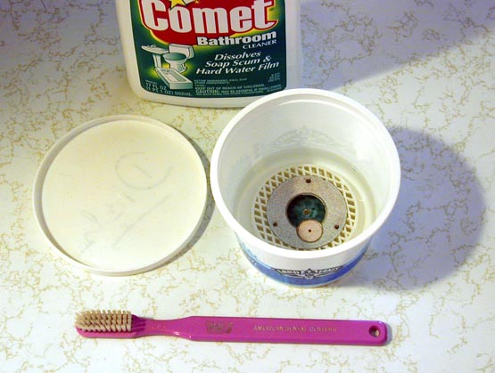

Welcome Tony! You'll see my "Dial Cleaning Kit" in the image below. I use that same kind of old and well-worn toothbrush for cleaning both dials and cases. That's a 16-size double-sunk porcelain-enamel dial you see sitting face-down on a plastic grid (optional) inside a used but carefully washed-out margarine tub. I leave the dial cleaner in the plastic tub between uses and wrote "Dials" on the lid with a felt-tip pen.
It is not mandatory to have that plastic grid but I felt it was a good idea.
My handy and dandy but not so professional cleaning kit...
