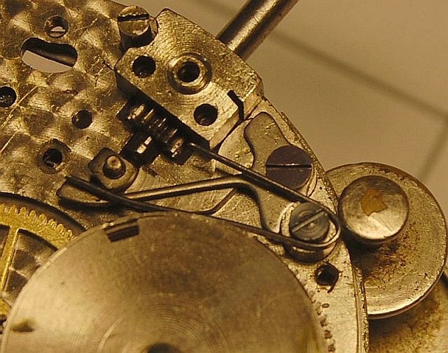

I'm trying to figure out why the stop start function does not work on this Excelsior. When I opened it up I found a spring that wasn't doing anything, so I've repositioned it. But, still not sure that's all that was wrong. Any thoughts would be greatly appreciated.

And after I changed it.

Next progress picture. Is this right?

Sadly I have no idea what to suggest. I took some "before" movement pictures prior to each stage of disassembly. It helped a lot.

Dave,
Thanks for looking.
I did re-assemble it and thought it was right. It worked, after a fashion, for a few times.
It would engage and dis-engage, but each time I had to pull the stem out to reset it.
Now, it's back to where I started.

Dave, that spring looks like a hand-made replacement. You might "shelve" the project and look for a NYS chrono parts movement. (with the same complications, as I think a few of mine had different swiss part sets.)

Dave,
You're probably right. I'll watch for another parts movement.
Here's a picture I borrowed on the net that shows a better looking spring. But, the watch is not quite the same as mine either, but close.

Dave I have the spring if you want it..N/C

Gary,
You're the man!
I sure do want it. And I'd be glad to pay for it.
Dave
How about that little cam on the top? I don't have that either, but not sure that mine is exactly the same.

And a great big thank you to Gary Cochran,
I received the spring I needed and the watch is operating properly for the first time, since I've had it.
