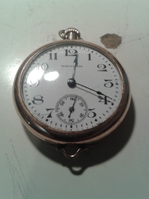

will put this watch aside until my new toys arrive and dig into a non running Waltham that just arrived. i only buy non runners with good cases and dials. they are so cheap and i love figuring out what is wrong with them.
