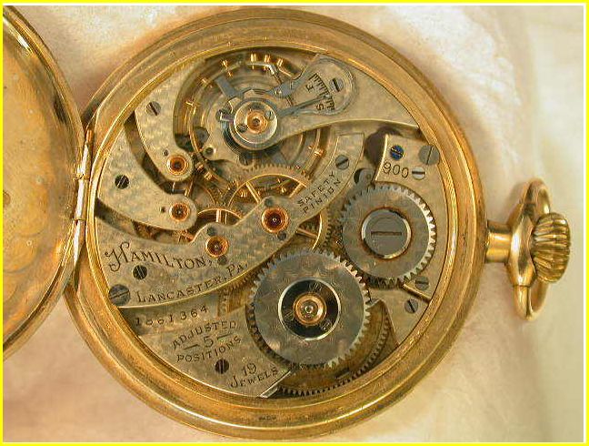

Hi - could I inquire of some help in finding how to 'power down' a Hamilton 900 movement - cannot find 'click'...Have even removed the dial (no help on that side either, as I can see).
Had an 18s 940 to power down, and found the 'click' could be accessed thru the side, but no luck on the 900 - Is would pretty tight and only runs for a short time - hope that a clean will be all it needs! Would not want to start undoing the winding screws....Does it have something to do with the spring near the "19j" ?

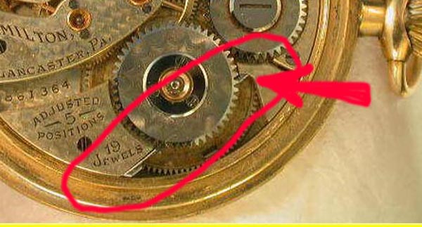

Chris AbellJust apply some winding pressure to the crown, you will see the click move this is the long finger type running under the wheel from "19 Jewels" to the other side, you then using a small piece of peg wood hold just clear while you allow the crown to slowly unwind, CAREFULLY!!!
