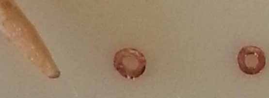

Mystery parts in cleaner basket
When I opened the cleaner baskets and was doing the head count for reassembly... these two washers appeared... I had absolutely no idea where they came from until I did the reassembly and figured out the balance had no end play. Instead of chucking up the staff and adjusting the length... someone had put these little washers between the pivot jewel and the cap jewels on both ends of the balance staff.
