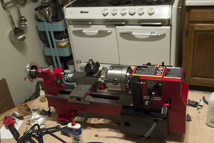

Harbor Freight 7x10 mini lathe made in good 'ol China! Lets just say this first: In no way is this lathe usable out of the crate! It's kind of a rebuild project but once you're done, you have a very capable and accurate little worker for not too much money. It came about 3 weeks ago in a banged up wood bottomed box. The thin metal chip pan for underneath and the back shield were really bent up and destroyed during ship but I didn't really want them anyway. Everything was covered with thick pink grease! But the good points are more numerous than the bad. It's got a flat, ground cast iron bed with decent mass and a very solid head and tailstock. I made several mods and fixes which included flattening and polishing the gibs, a larger 4" 3 jaw chuck, better handles and wheels, and the use of 10mil ptfe pads to cover the iron saddle braces beneath the bed; iron on iron was binding and galling. Bad materials selection? But in the most important areas for a small lathe, everything's well in place and completely serviceable. Weight with the 4" chuck is about 100 lbs.

William D. WhiteI got this lathe to make some small tooling for ...what else... horological adventures!

William D. WhiteAfter I got things snugged up, I was able to easily turn and face a piece of .75" case hardened rod using a brazed carbide bit with no howling and chatter as before. The 3-in-one smoked a little though!
