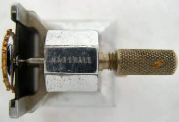

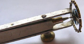

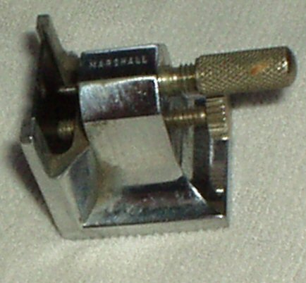

Wayne C. AndersonThe MARSHALL tool in use.

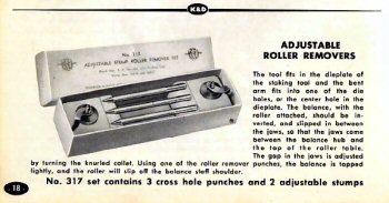

Wayne C. AndersonAnd not to forget the REX Roller Remover tool, used with a staking set.
January 20, 2004, 09:56
Wayne C. AndersonKevin
As you can see, there are many types of Roller Removal Tools, and each person probably has their own favorites.

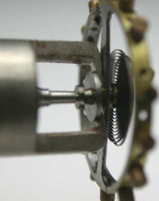

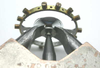

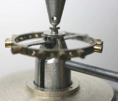

John D. DuvallI received this tool in rusted condition. It took about an hour of cleaning to get it serviceable again. It's my second choice of roller removing tools for a balance with the hairspring still installed.
John D. Duvall

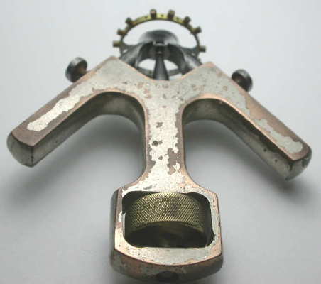

John D. DuvallFull view of tool with 16s balance.
John D. Duvall
Vice President, Education

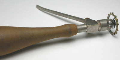

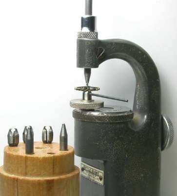

John D. DuvallI'm not sure of the correct name or model of this tool but it's my favorite. This tool fits most 16s & 18s balances. It also can be used with the hairspring installed.

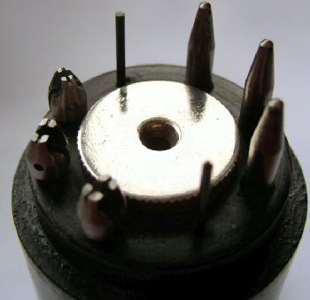

John D. DuvallI believe this tool comes in at least two sizes to cover most pocket watches.

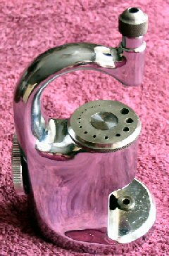

John D. DuvallThis tool can be found on eBay just about every week. They go for about $10 to $15 and are a bargain at that price.
Adding a couple of pictures in addition to Wayne's, I was trying to post this earlier this morning but I couln't connect to the site.

John D. DuvallAs you can tell by the pictures, the hairspring must be removed to use this tool.
It comes in a nice wooden box with punches and stumps to cover most wrist and pocket watch sizes.

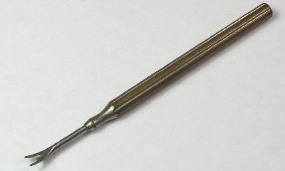

If you use the REX Roller removal tool that John D. Duvall mentioned, K&D made a hairspring removal tool.

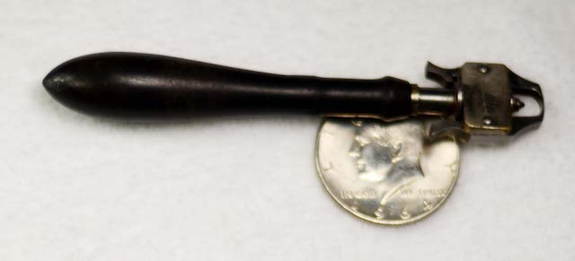

Peter Kaszubskiold discussion but another tool to remove the roller just got it form fellow member.
