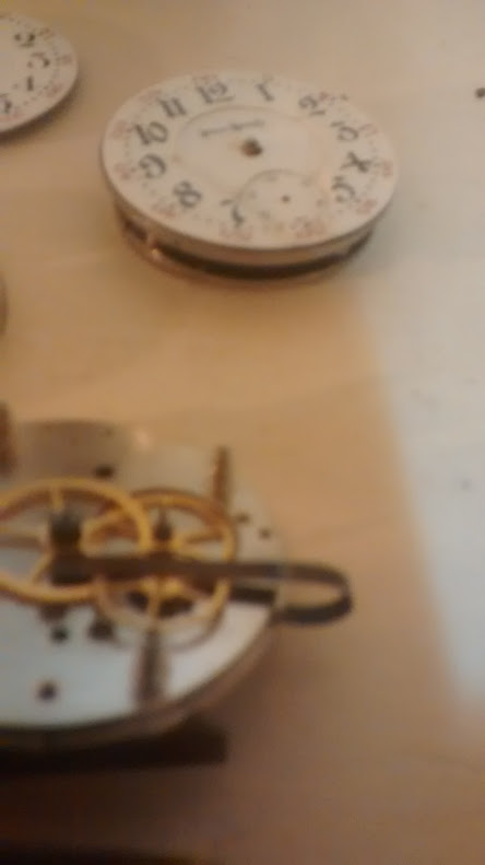

Hi JefF , Rodico is my favorite , another method is a C-shaped clip that can be made from an old mainspring and used like this picture shows,I hope this helps
