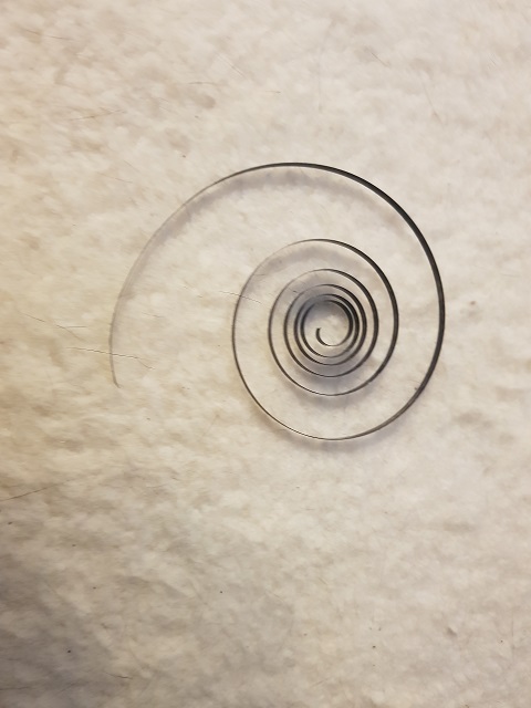

I own a Waltham 645 serial : 19034455 and whilst winding it up 2 weeks ago I heard a whirring noise and there was no tension left as I wound.Suspecting that the mainspring had broken I removed the barrel to check.The mainspring had broken where the loop attaches to the arbour.
My question is : Is this dark blue/black spring likely to be the original mainspring ?

Michael KosinenkoHi Gary, I don't think that there is a way to tell if the spring is the original one, as there are still new old stock blue mainsprings around today that could have been installed at any time.
Mike

Gary OrrisThanks for the reply Mike.
I did think that it may have been replaced before but I suppose there's no way of really knowing.
I fitted a new mainspring today, a silver coloured spring and the watch is now running again.
The mainspring I removed feels very weak & flimsy when compared to the new one.

Brian C.Gary, you did the right thing replacing a steel m/s with a white alloy unbreakable one, especially where you wear it everyday.

The 645 has been running all day with the new spring. It is gaining approx' 2 minutes an hour at the moment, I'll let it run fully down then wind again.... do this a few times and see how it settles.

Bila WirriganwaltersIs that 2 mins an hour Gary or 2 minutes a day. If it is 2 minutes an hour it is not going to come good, I would be have a close look at the watch to see it something is amiss.

Maybe the new spring is too strong for the movement.

I let the watch run down and then wound fully over the weekend.
Then, this morning, at 7am I wound the watch fully and set the time to a quartz watch I own. I've just checked the time after 15 and a half hours and it has lost approx' one minute so looking fairly good.
