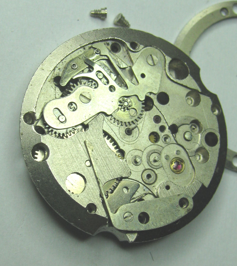

Christian E. GaldamesOnce again John thank you for answering my post. New news. I removed the dial nd found a big surprise.
This piece was just laying on top of the movement,loose.
Also. There seems to be a screw missing in the click area and the spring seems to be incorrectly installed.

John WoolseyChris, that bit of metal with its 'leg out of bed' looks like the click for the calendar wheel.
Try taking it off and putting it on t'other way round and see if it lines up with the gear teeth on the back of the date wheel.
Looks like someone's thrown a 'wobbly' having taken it to bits and forgotten how to get it back together again - and just stuffed all the bits under the dial!

Christian E. GaldamesIs this what you where suggesting the calender click goes???

John WoolseyChris,
Apologies for taking a while to come back, been a hectic week!
Ok, as you've got the lever set up now, the watch wouldn't run.
The wheel it's sat on is rotated by the motionwork, and would complete one full turn in 24 hours. The peg trips a tooth a time on the calendar wheel.
As it is now, the peg would attempt to push against the leg of the spring as it rotated and come to a stop!
You need to flip the arm over, and place the hole in the other end over the boss on the click where you have the arm mounted now.
The movement I have here has a whole bunch of gear missing off it (literally), plus the centre post is bust off.
I've assembled as much of it as I have, and posted shots below to show the orientation of the arm and movement ring.
The 'arrow head' on the leg of the arm locates in the toothed ring on the underside of the calendar wheel.

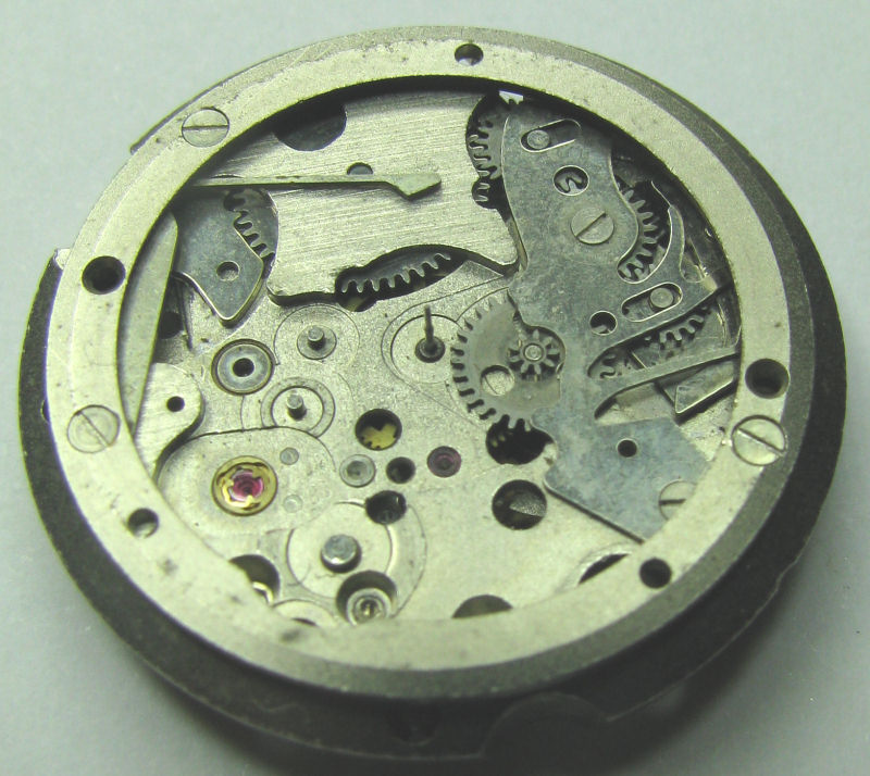

February 10, 2009, 14:42
John WoolseyCalendar click and ring installed.

Christian E. GaldamesThank you John. Your pictures are a big help.
This is what I managed so far.
It would also appear that the clicl spring is installed correctly in my movement if you compare it it with your pictures.
Now I can start to work on getting this watch winding again and see why it slips.
