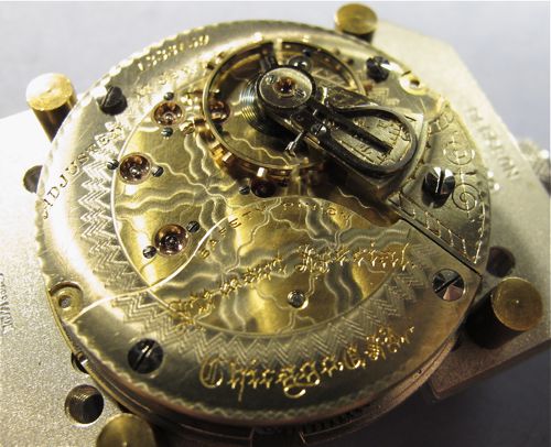

I am working on two different 18s Illinois full plate movements (model 6's), and they both have broken center wheel jewels. The jewel in the top plate appears to be a normal size that I am sure I'll have in my inventory, but the jewel in the pillar plate is a size that Seitz doesn't even seem to make. The diameter isn't the problem. A 260 diameter will work, but the hole has to be approximately 114 cm. The biggest jewel in my complete Seitz jewel set only goes up to 260/110. The 110 hole size won't work because the shaft of the center wheel mikes out at 111. I checked the websites of Jules Borel, Otto Frei, etc., but they only seem to offer the sizes that I already have in my collection. Where does one go to find a jewel like this? I'm starting to get a little worried
January 15, 2011, 20:27
Bruce StewartI never did find that bigger pillar plate jewel for the center wheel so I had to take drastic action. I put in a 110 hole size jewel, then turned the bearing surface of the center wheel shaft down from 111 to 108. Altogether, to get this watch running I had to replace two jewels, the mainspring, turn down the shaft, and do a COA. Everything turned out well, but it would have been a whole lot easier if those big Illinois center wheel jewels were still available! Forgot to mention, this is a "Stewart Special."

Samie L. SmithBruce nice movement looks like you did a good job.The Plate jewels with big holes are very hard too find and have not been produced for probaly 50 years if you find any for sale better grab them.
