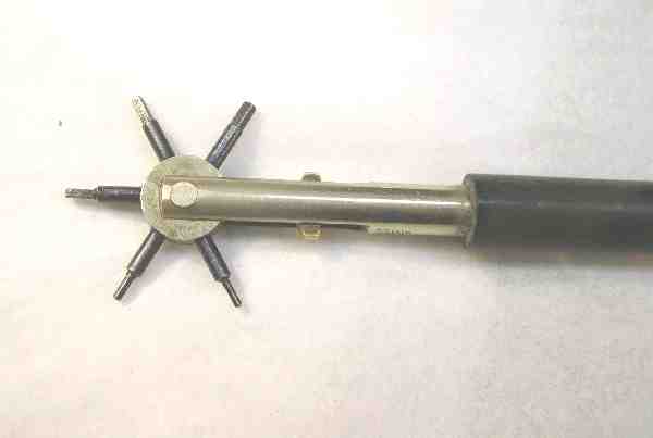

Frank Kusumoto
This is an old tool I picked up that is handy. It's convenient to have a one-size-fits-all tool.
March 29, 2008, 12:38
Edward Kitner
Nice Frank, that would come in handy.
