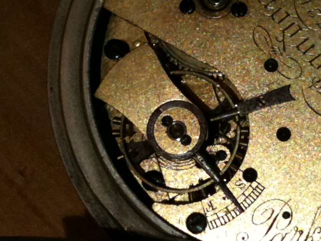

Hi, another question, I have a Duplex watch which is running far faster than it should, after cleaning and demagnetizing I think I'll need to replace the hairspring. Could anyone tell me what factors are important, I know the diameter must allow it to fit the regulator pins and that material can be important in terms of conservation, but what else do I need to know? Thanks,

Can you post a picture of the movement (balance wheel)?
Would it not be easier to add weight to the balance wheel?
October 26, 2013, 14:37
Joe Bradley
Hi Jon, I did consider adding weight to the balance wheel however there does appear to already be a lot of weights on there, and it is so far off that I'm not sure it would have enough of an effect (+/- a few hours per day). If you think it would help then I will try it, and if you could give me any tips it would help since I've not done it before. Sorry about the low quality picture I just took it quickly with a phone. Thanks,

I noticed in the photo with the hairspring visible that the coils are closer together on one side then the other. That hairsping should have even spacing between the coils. You probably have to manipulate the spring, as the coils could be touching each other therefore increasing the rate dramatically.

I believe Bila is on the right track.
Normally you should NOT have to replace a Hairspring.
I believe you have a underling problem like the hairspring is touch the balance cock arm, magnetized, out of the banking pins. or another mis diagnosed problems.

If you take a close look at the hairspring Joe you will see on the curb pin side that the coils are very close together, this is caused by the hairspring not being in the right form. When the hairspring is the correct shape the coils of the spring will be equal distances apart as well as passing thru the center of the curb pins. Also as Eugene has spoke about there are various other things such as the spring touching the underside of the balance cock to consider, close observation before applying any fix is always first recommended.

I had a similar situation that was simply a matter of the hairspring caught just inside the end of the two guide pins. Pushed it upward just enough to free it between the guides and the spring levelled out.
