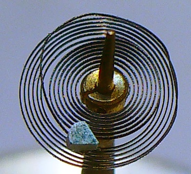

Patrick WallinCould you fix this? Distorted coils?
It's almost flat with a little bend on the inner set of coils (Collet) and then it has a area that is out of round and an area that needs to be brought back in shape.

David E. Booth, Jr.Good challenge, Patrick. Theoretically, I know how to fix that, but I have three or four "practice springs" in about that same condition, and still haven't developed the proper touch.
Then again, I consider myself a clock repairman, certainly NOT a watchmaker.

Paul DavisHello Patrick, is this hairspring from an elgin, I can make this one right, and if not probably have a replacement if needed, these are very delicate and easy to mess up, let me know what you think thanks,

Jon HartLooks like the HS needs to be cleaned 1st. The two areas I labeled on your photo the coils appear to be stuck together. Thus, increasing the gap on the other side of the HS.

Patrick WallinJon, you might be right. I thought is was just bent. I won't worry about cleaning until I get it useable. On second thought cleaning first would be the way to go.
