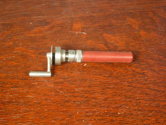

What winder do you use for a small clock, like a 37s Waltham car clock or one of the small airplane clocks? I dug through all the winders I have (that I know of) and the largest pocket watch winders are too small and the smallest clock winders are too big. What do you use?

Here is the tool that I use, it is made for doing these Waltham 8 day automobile clocks.

Larry, THANK YOU! As soon as I saw the photo I knew I had one. I just found it but it's missing the winding arbor. I'll keep on organizing and maybe I'll find it.
