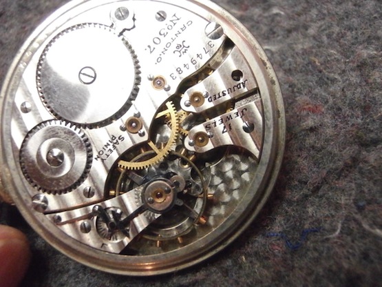

hi everyone,
so i bought a non-running hampden. it arrived today and this is where i stand.
i just opened it up.
1- the mainspring is fully wound. (tight)
2- the stem is in no way connected to the crown wheel. just spins freely.
3- the fourth wheel finger plate screw is missing. (obvious in the ad pic) newbie mistake. didn't see it.
4- the balance is good but it was over banked when i received the watch.
i lifted the balance cock enough to get the roller jewel on the correct side of the pallet fork and it seems to be good now although the watch does not yet run. 2 seconds then stops. but its really dirty. probably why.
in reading former posts here on overbanking i understand the many possible causes, but none of them seem to fit this watch.
the pallet fork looks good, roller jewel looks good.
is it possible that the overbanking issue was caused not by mechanical failure but by mechanic failure?
did someone take this watch apart and reassemble it overbanked?
the missing screw makes me think so.
tomorrow i will disassemble the watch to look at the keyless works, i expect a stripped winding pinion or clutch.
will be asking a lot of help there.
thanks everone
Todd

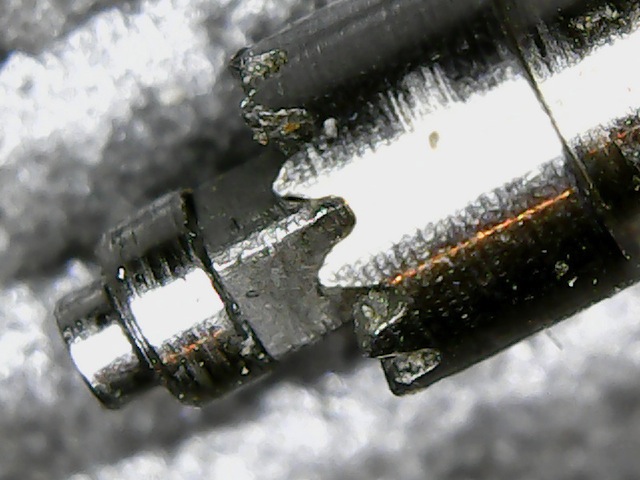

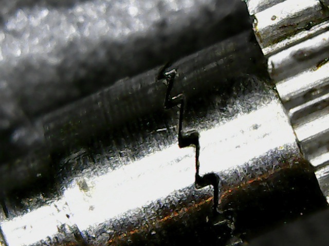

so, i have disassembled the movement.
everything looks great. filthy and oily but great.
had a little surprise. it looks like the third and fourth wheel are held in place by individual fingers. turns out to be an illusion.
those two fingers are actually part of a single bridge.
turns out my theory of a stripped winding pinion is completely wrong. the assembly looks great! (pics)
using a bench key everything seems to work.
is it possible i just need to tighten the stem nut with a sleeve wrench?
thinking about reassembling the movement just to try that.
going to clean it tomorrow. see what happens.
the missing screw from the bridge is actually broken. the business end of the screw is broken off flush to the bottom plate. going to go buy some alum tomorrow. if that is a bad move or someone has a better idea please let me know.

finally figured out how to post pics from my microscope.
