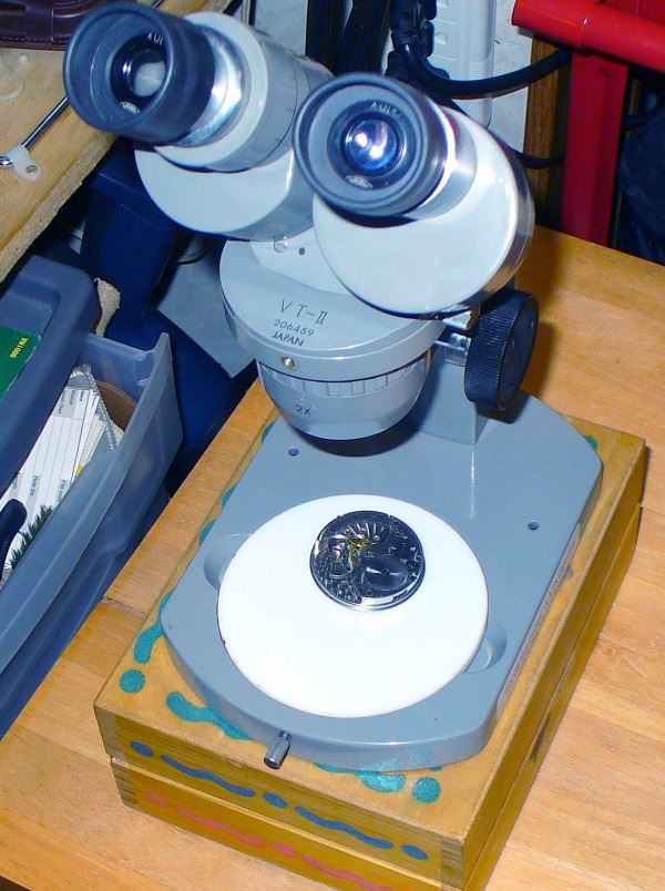

Patrick WallinMy New Olympic Microscope
Other than a Staking set and a Lathe I think it is the best purchase I ever made! I have been able to see and find problems I never could have with a Loupe. I recently COA"d a Rockford, my first, and after a ultrasonic cleaning would normally put it together but after checking in the scope I found it to be still dirty. I run it through the bath again and then looked at it and it was much better but still had some crud in the jewels. I brushed this clean and rechecked for assembly. So, we have a Rockford I thought was all ready to go and then found problems using the scope. It's together now and runs perfectly and I know it is clean and has no problems.

Patrick WallinCurly and Roger., Curly the model # is VT - II. The 45 degree head is very useful as you sit at the bench and look into it it. The eyepieces are adjustable for the distance between you eyes. It has a two stage focus meaning it will raise or lower twice what it originally appears to. It has a double focus of 1X and 2X and is also adjustable at the eyepiece.
Good, crisp clear focus fine enough to count the teeth in a fruit fly.

Patrick WallinFocus is easy and there is plenty of room to work. It's definitely not cramped. This same scope can be boom mounted if you have one. It would take <5 seconds to change it.
Using a scope you will find that 80% of the watches you COA have a jewel problem that a regular loupe wont show. Loose roller jewels and escape fork jewels that rock when you tickle them with a tooth pick. I have thought I was putting together a clean watch and then under the scope find it needs to be bathed again.
I can't say enough for using a microscope. Shellac has a shelf life, both in it's raw state and it's applied state. A scope is GREAT for locating loose jewels and installing roller jewels.

There are a lot of boom mounted scopes on the Bay. Some for as little as $200.00. You can get a fixture mounted scope for around $180.00 but when you add a boom it gos up drastically. Every body thinks our money is no object.......I have found a boom for mine but it's going to cost me $+-$200.00.

Patrick WallinI love it for turning pinions to get a polish on them. You can see if it's smooth or still needs a little more buffing on 1x but switch to 2x and you can see everything.
