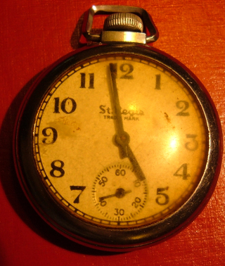

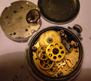

Dave TurnerHere's My Ingraham St. Regis before and after cleaning. Takes a while to get that full plate lined up!

Dave TurnerFinished and running now.
May 21, 2012, 00:14
Ray HallenbeckWow, good job Dave. Most will never get these together once they are taken apart, I know this because of too much personal experience
