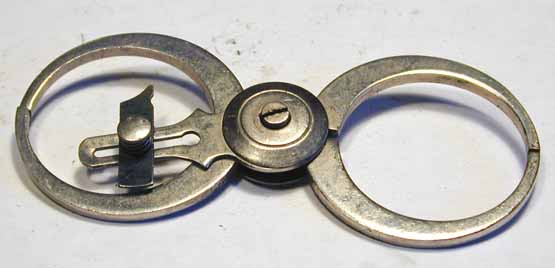

December 12, 2012, 09:49
Dave Turner
What application would this have? There are no pivot holes.
Vintage Antique Poising caliper for watch repair, watchmaker
