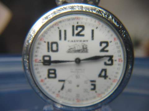

Ernie Loga
The case houses a swiss watch with the name Calvert on the dial. It says it is 17 jewels. It runs but gains time. The case has an engraving of a train on the back cover.

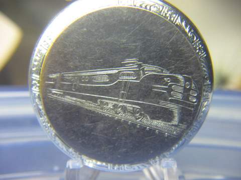

November 27, 2009, 22:49
Ernie Loga
Here is the back cover.

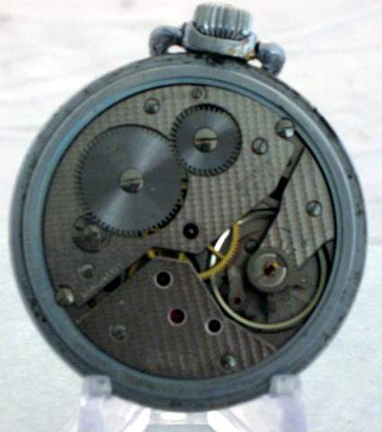

Success: The cover is off. Thank you to everyone who offered helps. I appreciate each one of you!
I tried rubber gloves, I tried a rubber used for opening jar lids, I tried the non-slip shelf liners for campers and tool boxes. I could not get enough grip to loosen the cover.
Finally I super glued on a 1" nut to gain as much surface grip and leverage as I could. I had to use a lot of leverage with a 1" wrench. Just about the time I thought I was using enough leverage that the super glue was going to break loose the cover unscrewed.
I then used acetone to remove the super glued nut and clean the glue off the cover.
Here is a photo of the Delmont Watch Company Movement that was hiding inside. It is now happily ticking away on my desk and keeping time. However the regulator is way out of position.
I do need to find a second hand.
