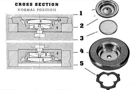

John - Do you know where I can find a diagram of a KIF flector assembly? I'm used to old pocket watches and very new to the shock mounted balance jewels. Anyway, I got the retainer spring off (and found it, thank God), checked the hole and cap jewels, and then tried to reinstall the spring. A good picture or diagram would help a great deal. Any ideas? Barry B

This is the original KIF design, which I beleive your Bulova has:

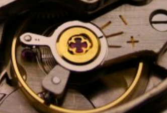

Mike - Mine has a four-lobe spring with only one tab. 180 degrees from the tab is a raised section. Apparently it is called a KIF flector assembly. Trust me, mine is different.

Does it look something like this?
April 28, 2006, 13:08
Barry Boling
John - Exactly. Barry
