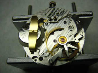

Balance back in and trip and contact wire properly adjusted after cleaning the contact.
February 12, 2009, 17:37
Scott Cerullo
It was a lot of fun working on this one. It was sent to the service center in Jersey and returned unfixed. The contact and trip wire were moved far away from where they were supposed to be. Fortunately they weren't damaged. If the contact, coil and wires are in good shape, and it is cleaned properly, the Hamilton Electric is a pretty good runner. The big problem is parts, but not an impossible situation as of yet.

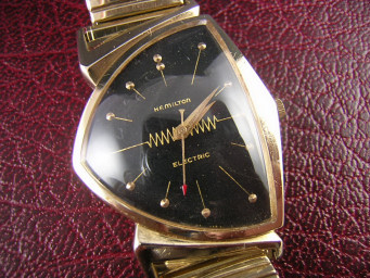

I think that this is a pretty rare watch. It is a all yellow gold Hamilton Pacer Electric. I think most of them were two tone.
