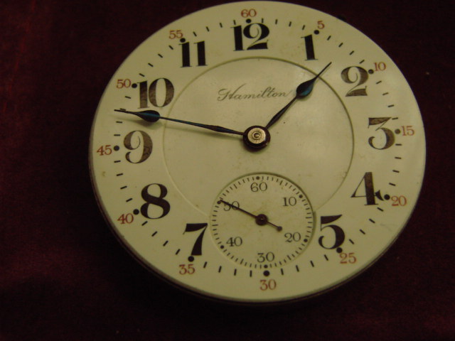

A lovely 23 jewel Hamilton gold train 950L movement serial # 1150053 I got at the pawn shop day before yesterday

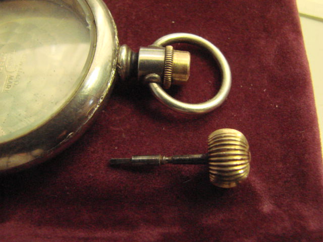

in a sterling silver tilt-out case that they pried the bezel off not knowing it was threaded !!
Anyways the balance and mainspring are good but it wont engage to run. The dial is perfect ,not a chip or a hairline! Is there anything unusual or rare about this one or is it just a lovely old Hamilton. Also is the stem held in place by the ends of the bow in this type case , as it falls out and I see no screw ??? Do the ends need to be re-milled and tightened in??

Tom Brunton#4 Don't know as I've seen a knurled gold flange on the crown post like this before??

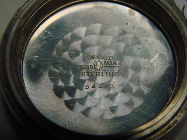

Tom Brunton#5 C.W.C.Co.trade mark a 1/4 moon and a star Sterling #54161

Marc MicaleHi Tom - wow - nice - you seem to be picking them up from everywhere! As for as the case goes, I have one - with one of those Knurled gold flanges on the crown post... they unscrew to come off. I have taken them off to clean before.
December 17, 2010, 23:56
Eugene BuffardTom, Below the brass colored dust cover that does unscrew is a stem sleeve. of coarse you need a sleeve wrench to remove and replace. Since the bezel is in such bad shape it might be better to replace the case.

Tom Bruntonhi Richard; the roller jewel is in place. I removed the balance bridge and put it back in, and lo and behold it was running. Then I noticed that the hairspring was over the edge of the gear. I carefully placed it under but noticed that the hairspring is not between those two pins. Not much wrong with it for sure, thanks , and Merry Christmas

Tom BruntonTook down the balance side ,the balance pivot jewels oil had evaporated down to black gum ,cleaned and oiled that side and away she went ,now she's running like a racehorse! I'm not set up to use an ultrasonic cleaner right now so for the time being I left the dial on but she should get a complete COA
