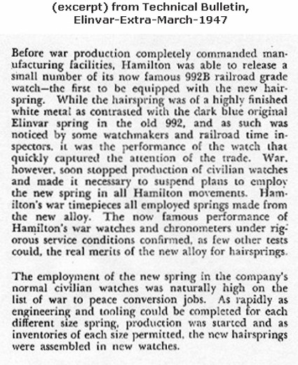

Donald,
I might add to Lindell's comments that when the 992B was introduced in 1940 a much improved Elinvar hairspring was used and designated "Elinvar Extra" in their literature.

Donald,
Below is some additional info from a Hamilton Tech. Bulletin about the "Elivar Extra" that may be of help.

I now see why 992B's are so highly reguarded, and where their intrinsic accuracy comes from. My two 992B's are the most accurate watches I have. One of them will give a quartz watch a run for it's money! If I keep it wound properly, it never has to be reset. It keeps perfect time!

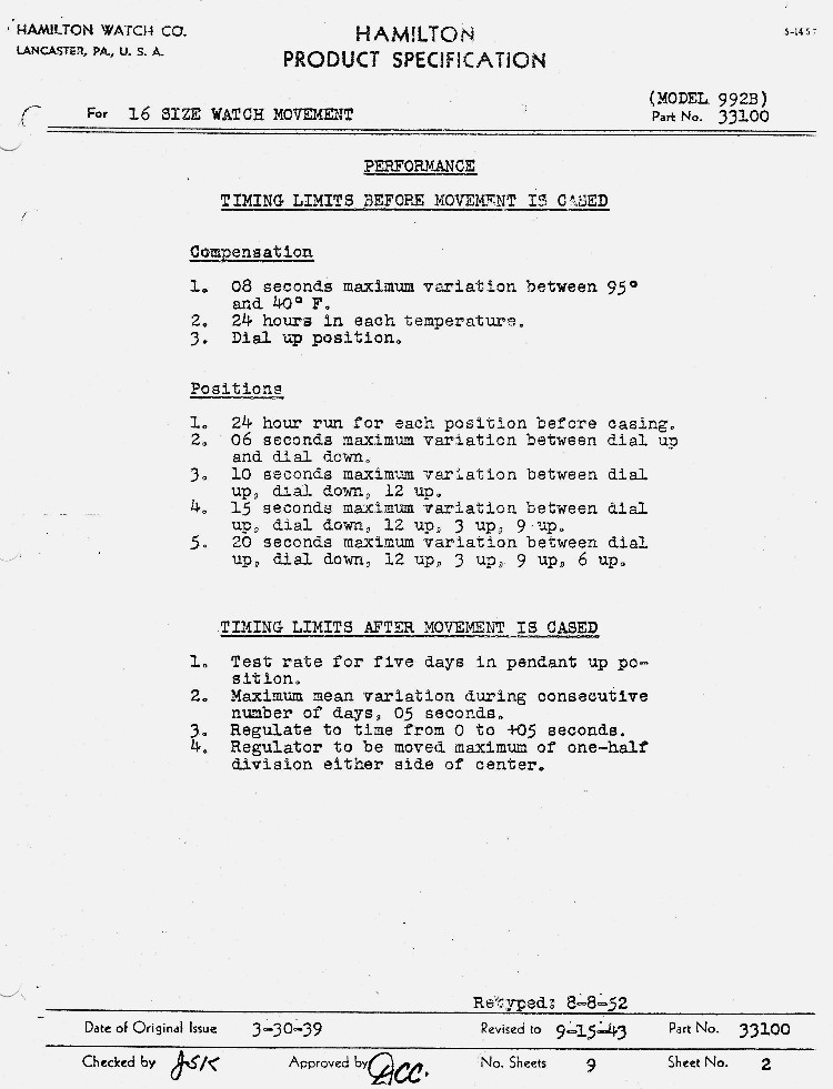

Donald,
Below are the product performance specifications for 992B movements.
