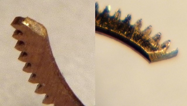

I found a broken 992 gear and it looks like plated brass under a loop.
Hard to photograph and hard to tell from the pictures.
Under side view on the left.
Problem is, just because this one looks to be plated, doesn't mean some were not solid.
Steve
