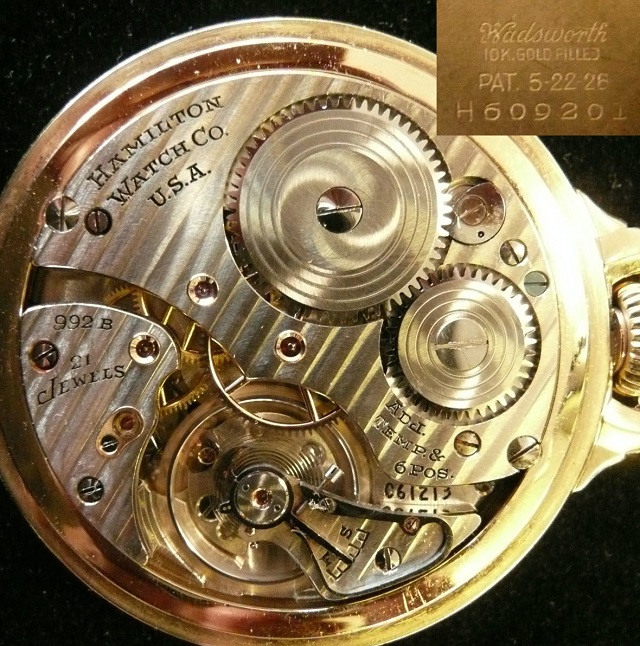

Shown below are 4 watches I consider to be correct movement and case number combinations that match the Wadsworth database numbers. The first two are close to the case number in question and the second two the movement number. These combinations offer some variances that I consider worthwhile to explore.
First we have a Second Signature movement with a gold center wheel and circular pattern winding wheels.
1. H609201 and C61213

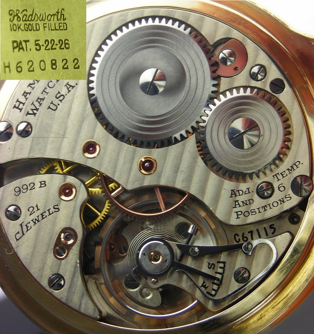

Next is an early Third Signature movement with a gold center wheel and circular pattern winding wheels.
2. H620822 and C67115

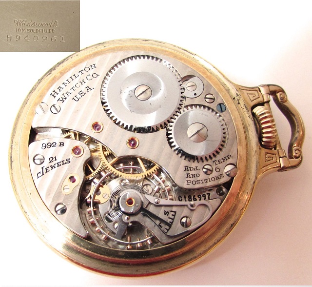

Here is a Third Signature movement with a brass center wheel and plain pattern winding wheels.
3. C186997 and H940961
November 16, 2014, 18:13
Richard Romero
Finally is a Third Signature movement with a brass center wheel and plain pattern winding wheels. The newer Wadsworth case backs are not stamped PAT. 5-22-26 like the first two shown.
To see the different signature movements and features refer to: 992B Movement Feature Details Database

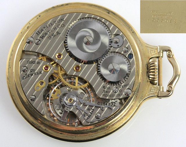

A watch recently sold on ebay with corresponding movement (C190xxx) and case (H620xxx) numbers to the ones in question here. That watch has issues which will be posted in the pitfalls area.
RR
4. C194832 and H955082
