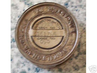

I read the movement number as C161768 and the Grade number as C90, although both are a little indistinct for me. It would beinteresting to know some more about that grade number.
