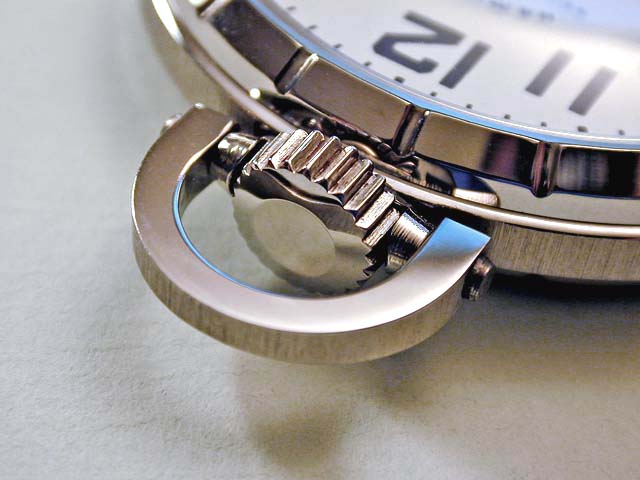

I would be very interested in any comments about this model #15 crown. It is a very early Star case serial number R1229xx, movement C300xxx. The crown has a rim made of aparently SS, but not found on other Hamilton cases. Was this leftover from an earlier model?

Matt,
The crown on your case looks to me like it may have originally came on one of the Star Stainless-Steel Cases made for Elgin in the 1950s time-frame. Hamilton Model 15 Cases which of course were also made by Star used a two-step crown design as you'll see shown in the image below. I tried to take this picture at essentially the same angle as yours so you could see not only the difference in the crown but how a proper crown will actually fit into the overall case design more precisely.
Hamilton Model 15 Crown and Bow Design...

Thanks for the mint image of the Mod. 15 Lindall. Perhaps, since it was an early Star case, Hamilton was supplied with an Elgin crown? (I'm not sure if the Elgin pre-dated the #15) A second theory is that the original was replaced later with a traffic special crown? The watch has many jewlers marks indicating regular service. Also, the bow pins have pointed ends instead of rounded and a tappered thickness bow towards the top.
