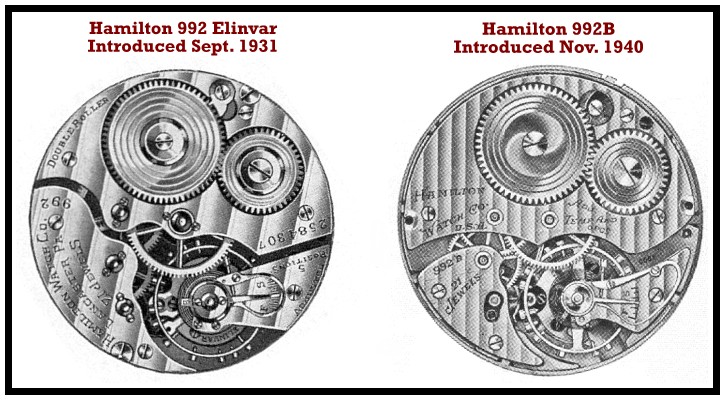

Below is a side-by-side view of the Hamilton 992 Elinvar and the 992B.
The images are excerpts from Hamilton catalogues furnished by Don. Thanks Don.

Thanks Robert. Now I have it. The 992E came between the 992 and the 992B. Learning all the time. Was there any overlap or are there definate dates when you can see the transition in the records.
