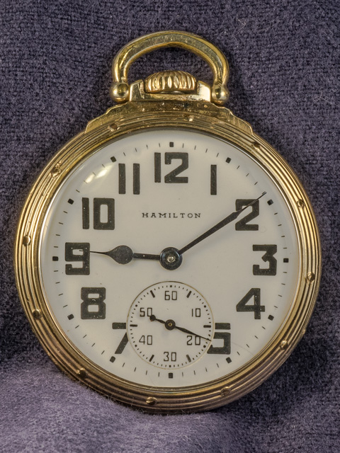

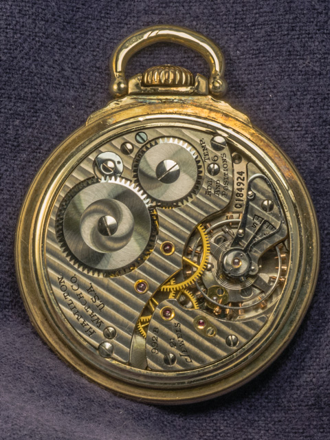

Russell MiltonHi Richard,
The first photo shows the dial has a fine crack through the number 5. Also the crown is a bit askew. Both the crown and bow are a bit loose.
The second photo below shows the movement.
Russ

Richard RomeroRussel,
Nice watch, looks entirely correct. Movement from 1947 when the Model A shouldered version was coming to an end.
Hamilton Case Question "Shouldered".You can confirm the case number here:
KEYSTONE-HAMILTON CASE A, 11, 14 AND 17 DATABASE EXAMPLES YEAR-BY-YEAR The 080 SS porcelain-enamel dial was advertised on the Model 12 case in 1946 (See below) and it's correct for 1947.
Hamilton started phasing in melamine dials approximately a year (1948) after your watch was produced. Melamine dials aren't as durable as porcelain-enamel and many are no longer usable.
Correct matching hands.

Larry LamphierRussell, welcome to the best club in the world to learn about these great railroad pocket watches.
You have a really nice Hamilton Railroad pocket watch there. One of the BEST!!
I guess I wouldn't worry to much about the timing until it has a good COA = Clean Oil and Adjust. You will find that once it is cleaned it will require different adjustments to get it timed again anyway. For a 70 year old watch 9 seconds a day is pretty good. I assume that was in the face up position. I notice that the regulator is a little to the slow side of center. that in itself could be an indicator that it is in need of service. There are some really good people here that can answer your questions, and even service your watch for you if you decide to have it done.

It is nice to hear that my watch appears to be all original (including hands), correct for its year of manufacture. I was also pleased to learn that it is near the phase out of both the shouldered case and the porcelain-enamel dial. Some of those melamine dials are poor when they get very old.

I'll follow the advice given by yourself and Richard to get a COA when I get done checking its rate. Since I already have checked its rate face up, I wanted to try checking the rate pendant up. I'll refrain from making any adjustments myself. From the looks of the worn screw heads and scratches on the movement, I assume it has been serviced in the past. How long ago is anyone's guess.
Does a standard COA include adjusting to factory specs? Would that include adjusting the balance wheel weights and timing with one of those timing meters (I don't know the correct term)? Any suggestions in finding a good place to get a COA?
