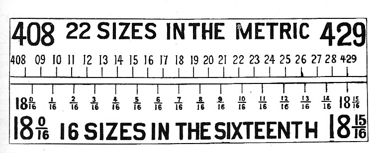

Here we have a "Crystal Size Ruler" from a 1935 Material Catalog.
Are these hard to locate?

In the best of all world's, Robert, I suppose we could simply measure the crystal size and order one.
But.... at least in my experience, it is not all that unusual to find that the bezel has been "worked" and is now difficult to fit.
And Hunters? I've come so close to finding crystals for hunters, only to learn that the dome was too high for the case to shut.... or the crystal was too low for the hands to clear.
I'll still go with trial and error.
