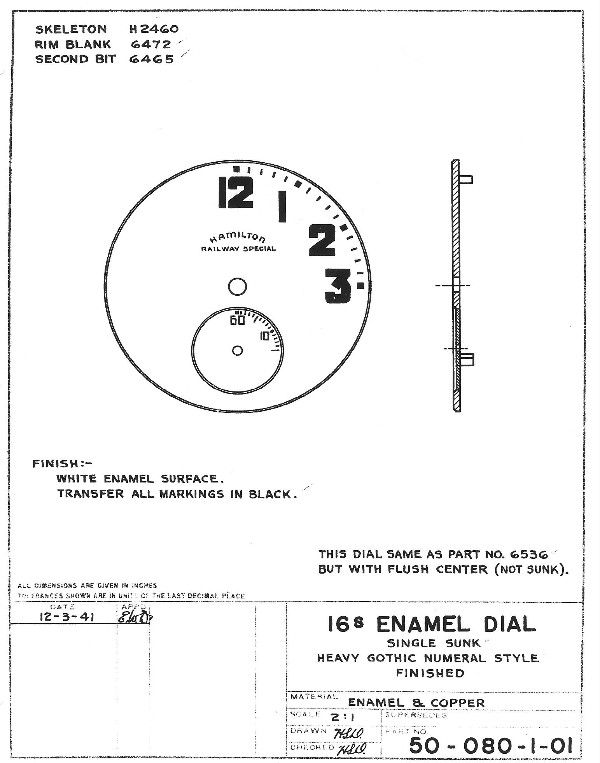

Hello Malcolm,
Based on the description of your early 992B dial, I believe you have a model 080 dial which is shown below.
The HG (Heavy Gothic) on your label only identifies the numerial style and not the actual model or part number of the dial.
If you could post an image of your later dial, it would help to identify it.
Robert
-Credit goes to Don for this image-

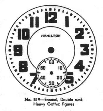

Mr. Sweet - I would love to post an image but haven't yet mastered the process. The C63,085 dial is exactly like the 519 dial that I saw on one of Tref Young's previous posts where he had the 992b dials pictured and identified. Is the 519 in the right time frame?

Malcolm,
I believe (someone correct me if I'm wrong) that the 519 is a pre-992B HG DS enamel dial. The 536 dial is same as 519, but includes the RWS signature.
It (appears) that you have the 519 dial, but still again a image would be very helpful.
It's really not that difficult to post an image, just click on the "CLICK" TO ADD IMAGE ATTACHMENT, and browse your hard drive for the image. Just make sure it doesn't exceed the maximum size (< 222 kb).
Below is an image of the 519.
Robert

Robert M. Sweet
Malcolm,
I would conclude that your dial is a model 519. What is the opinion of others?
Robert
