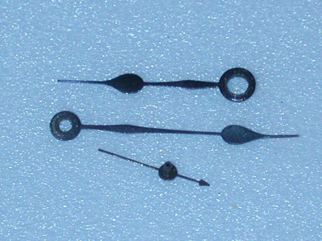

Hi,
Will the hands from a early 992 interchange with any grade of 16s Hamilton movement? For example will the hands from a 992 fit on a 974 movement and vice versa?
Donnie T
October 21, 2013, 00:33
Harry J. Hyaduck Sr.Yes they will. I have seen a little variance in the hour wheels but they should fit. By that I mean they may be tighter on one movement than on another but that is not grade specific just the difference in the tolerance itself in the different runs. I'm not sure if this holds true with the large plates but they probably fit them also.
