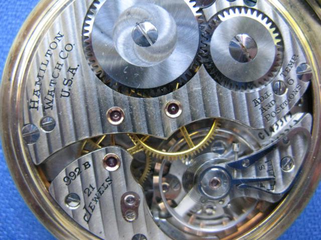

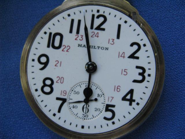

Hi all,
Would like the experts here to tell me what I have here, and of course if it is anatomically correct in all ways. I would like to know if the case, hands, dial and whatever else is all correct.
The dial appears to be perfect, no h/l, the hands appears right, the movement exceptionally clean, and the case has minimal if any wear, at present it appears to be keeping RR time, but will not wind it again until it is serviced.
thanks,
Bill

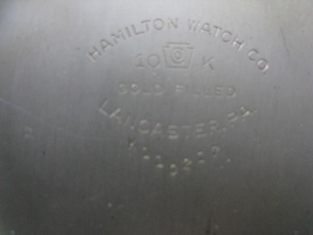

I believe this to be a 090 dial, Mdl 11 case, and the watch ca: 1946. I just wanted confirmation on what I was reading was right,
Bill

This is not my bailiwick but from what I read you are correct. Can you confirm the serial #'s?
Mvt. - C143379?
Case - ???????
If you ever come across one made in 1951 I will be interested.

Bill MandersHi Lorne,
as a matter of fact, I was kinda feeling that way.
The serial number is C143379 and the case # K110227.
Bill
July 21, 2013, 12:28
Lorne WasylishenThat is the right date for a Keystone Hamilton case as well.  I was hung up on the Wadsworth H and J prefixes but there is a link to the Keystones:

Bill MandersI am just bringing this up again, because I do Know that there are very knowledgable members here about Hamiltons, are my interpetations of the
records correct, and is this watch correct,

Edward L. Parsons, Jr.Bill,
Your 992B is from 1946 production, so the shouldered Case 11 is correct and and Dial 090 is also correct if it's porcelain enamel.
After 1948, that same 24-hour design with red 13-24 numerals was used on melamine dials, but those would not be correct on a 1946 992B.
I'm moving this discussion to the Hamilton forum, which is where it belongs, with a shortcut to it where it was originally posted.

Larry LamphierThat is interesting as I thought the single sunk 24 hour dials in red were military dials.
Still learning!!
August 02, 2013, 18:24
Bill MandersHi Ed,
It is a porcelain enamel dial,
