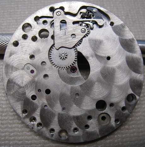

Can you also recheck that dial measurement, which position are you measuring on the dial, can you also upload a photo of the back of the movement and dial plate without the dial?
January 06, 2021, 22:02
John P. StollIt measures 4.70mm thick and I'll attach a pic of the plate. Let me know if this helps.
January 07, 2021, 08:38
Bila WirriganwaltersWith that setting & winding Mechanism it's looks to be a Unitas movement John, any of the Cortebert's I have seen have a different setting mechanism.
Did not Unitas take over Cortebert, the only size Cortebert I have come across that is 4.70mm high is a 16 Lignes?
The Unitas movements that are 4.70mm high and are 18.5 lignes all take a "Flume" staff #U1487 or Ronda Staff #3712, other staff makers/suppliers you might be able to cross reference.

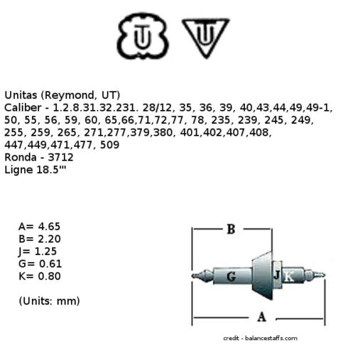

John P. StollFound this on EBAY for a Ronda 3712 Staff.
February 01, 2021, 12:00
John P. StollUpdate: I tried this staff and it wasn't the right one. It was too long, 4.65mm. I measured one out of a good watch and it measured 4.05mm. I ordered a staff from
https://www.hamiltonparts.com/.
It comes in two versions, .8 and .9 collets. I think another possible staff would be a Ronda 2929 staff. The measurements match.
