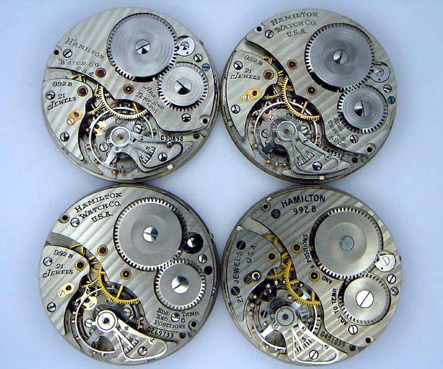

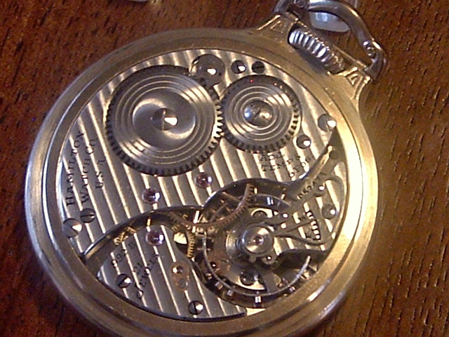

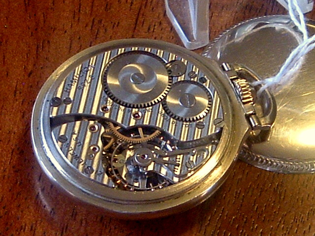

I have the four signatures of the 992B and I just noticed the crown and ratchet wheel on the sig.1&2 have circles on the wheels.Whereas,the sig.3&4 do not,they are plain.Is this correct? I do see others where some will have one of the wheels with circles and the other wheel will be plain.Am I to assume that the watches with the mixed wheels not to be correct?

Edward L. Parsons, Jr.Yes, the Signature Types 1 and 2 have the circular damascening on the winding wheels. Later plain winding wheels were introduced, presumably as a cost saving measure.
The plain wheels were phased in, so you may find early Signature Type 3 watches that also have the circular pattern on one or both of the winding wheels.
On later Signature Type 3 and Type 4 watches, both wheels should be plain.

Buster BeckHere are some additional facts that Ed posted back in April 2011;
Just from my memory and personal observations, I can give you a ROUGH GUIDE as follows:
Signature types (see picture) represent different periods of 992B production, starting with the Type I in 1940 up to about C35000 in 1941-1942, then Type II ran up to around C62000 in 1943 which indicates Type II is the least common variant. Type III continued from there until about C410000 in the 1953-1954 time frame. Type IV was then used through the end of production.
Dials -- By 1950 the dials were all melamine.
The Four 992B Movement Signatures
Top Left: Type I ------- Top Right : Type II
Bottom Left: Type III ------- Bottom Right: Type IV

Lorne WasylishenThanks Ed & Buster, I have pilfered a screenshot.
Buster, what do I owe you for copyright infringement?
