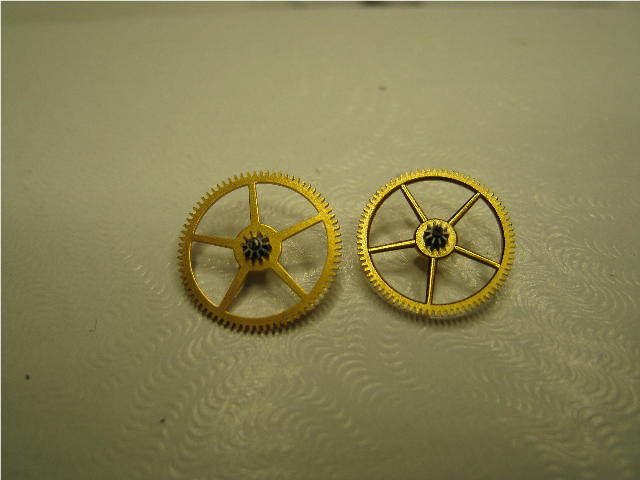

This may be a new guy question, but are there two types of gear trains in the 992Bs? I have a watch that has a fourth wheel that doesn't match the rest of the gear train, cosmetically. I've included a picture. The fourth wheel has a round top to the spokes, while the rest of the gear train is flat on both sides. I couldn't keep the watch running, until I finally substituted another fourth wheel that was flat on both sides matching the rest of the gear train and now it runs without a hitch. I think I see a difference in the teeth, but I'm not sure. Could someone enlighten me on the subject? Thanks.

Edward L. Parsons, Jr.You are right John, this is a question that has been asked and answered MANY times in the past. The round spokes are a result of a casting used to make the 4th or center wheel.
The first 992B center wheels were cast, gold-plated and highly polished to give them the look of a solid gold center wheel. Around movement number C118000, the gold plating was dropped and later so were the castings, so the center wheels were stamped out of flat stock like the other train gears. This results in a rectangular spoke cross section.
