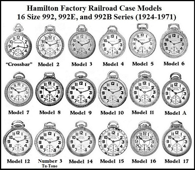

The dials following coincide with Hamilton Factory Railroad cases...April 04, 2011, 00:46

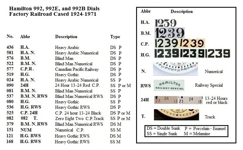

Descriptions used...April 04, 2011, 00:51
Richard Romero

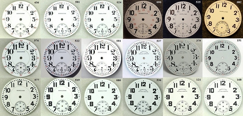

Dial Numbers...April 04, 2011, 00:51
Richard Romero
992 and 992E Dials...NOTE: The only dials we find offered as original to 992E movements are the 576, 522 and 519 described in Hamilton catalogs of that 1932-1939 time-frame. In addition the 581 appeared on the 992E in 1932-1933 catalogs. All 992E movements were factory cased and before that all 992 movements were factory cased after 1929 production.
April 04, 2011, 00:53
Richard Romero
992B Dials in Porcelain-Enamel...April 04, 2011, 00:54
Richard Romero
992B Melamine Dials...NOTE: Hamilton began phasing-in the melamine dials in 1948 and by 1950 the change-over was complete. The earliest melamine dials were smooth and shiny but gradually the surface became increasingly dull and of greater porosity. Many survivors have surface cracks and loss of intensity on the numbers and letters.

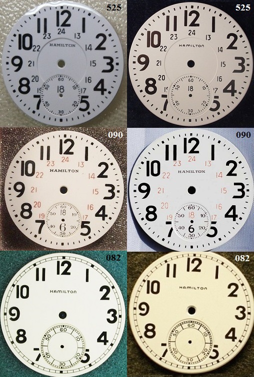

992B Dials in Porcelain-Enamel and Melamine 525, 090, 082...Dial numbers 525, 090, and 082 were first produced in Porcelain-Enamel then Melamine versions were phased in as described above. Here are some ways to identify differences between them.
The 525 dials have two different “HAMILTON” signatures. The porcelain-enamel dial signature letters are bolder and square whereas the melamine version letters are not as pronounced and the letters M and N are rounded. Also, there is a difference in the size and location of the number 18 within the seconds bit.
Notice on the 090 dials the porcelain-enamel dial has a black number 18 in the seconds bit and the melamine dial has a red number 18. The number 6 hour font within the seconds bit is also different between the two dials.
Looking at the 082 porcelain-enamel dial numerals you can see they are bolder especially on the hour numbers 4 and 8 where there is a noticeable difference of how much white is visible inside the numerals. The porcelain-enamel dials will typically be shinier and brighter.
Porcelain-Enamel Dials on the left, Melamine Dials shown on right...April 04, 2011, 01:04

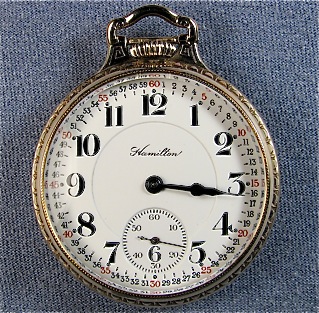

Richard RomeroNOTE: If a dial is signed only as "Hamilton" in script it is too early and incorrect for use in any of the cases illustrated above. Hamilton began to phase-out their script signature in 1918 and by the time their Crossbar Case was introduced in 1924 the Hamilton script signature as shown below was a thing of the past.
Pre-1920s Hamilton script signature...April 04, 2011, 02:09

Bruce StewartLooks like I have the wrong dial on my 992 Elinvar! The case is a Wadsworth #2, 10K Gold Filled, Pat. 5-22-26. Case serial number is H255985, and the movement number is 2,582,021. Thanks.

Richard RomeroBruce,
The dial is on your Elinvar is pre-1920s which is too early for your movement which dates to 1930-1931 according to the Gelson List and your Model 2 case dates to 1938 according to the Wadsworth-Hamilton Case Database so it looks like things are more than a little mixed up.RR

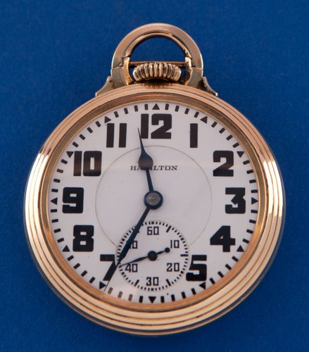

Robert McClellandRichard thanks for the great information. I have a question on the dial on a 992 E. It looks like the 519 shown above but the hour markers are triangular instead of square. Is this just a variation of the 519 or what? Hopefully it is legit since I bought it but don't have it yet.
Thanks
Bob
April 16, 2011, 12:17
Richard RomeroBob,
You're welcome as well as all that have given thanks.
That's a great looking dial which is definitely legit. I would describe it as an "Arrows Out" Heavy Gothic DS porcelain-enamel dial. It's a variation of the 519 dial except the five minute markers are triangular rather than rectangular. As far as I know there is no specific number for it. The dial is an uncommon variant used on the 992E for a very short time.
In conversation with Lindell he explained these "Arrows Out" dials were used by Hamilton approximately circa 1931-1937 plus or minus a year. Another variant of this dial was used on Illinois movements. The Illinois version looks the same except it is signed "Illinois" in an arch rather than the straight-line Hamilton, otherwise they are identical in appearance.
RR
April 16, 2011, 12:45
Robert McClellandRichard thanks for that information. Lindell also contacted me to let me know that it is OK. He pointed me to a photo of one of his with that dial in the
Hamilton Wadsworth database and gave me the movement number of that one. When I get the watch I will post the movement number so we can see how close to each other they are in time.
April 18, 2011, 16:35
Robert McClellandI got the 992E pictured above today. The movement number is 2599978 putting it in the 3rd run of 992E's which goes from 2597001 to 2608000, 1935-36-37. This is the same run as Lindell's (2606463) which is pictured in the Hamilton Wadsworth database. The Wadsworth case is # 0952156 which puts it in 1936.
