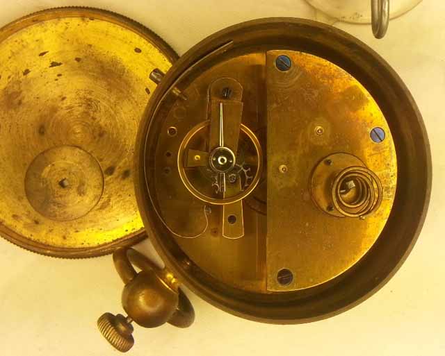

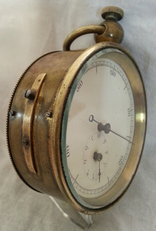

What an interesting piece to open and service. Works like a champ... ran 1 second fast on a 10 minute run.
Hands are hand made. Screws are flame blued. Cylinder escapement. Wolf tooth click. Wind stop mechanism. Starts and stops with a slider to interfere with the balance. Self contained 4 Jewel balance assembly with 2 jewel escape. Staked flat hairspring.

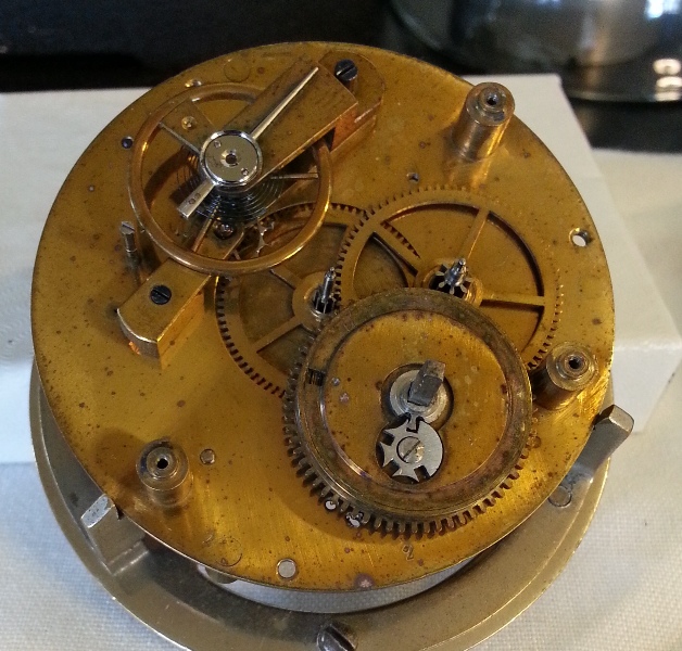

Paul D. Trombley
Good look at the slider and winding disc
August 09, 2014, 19:59
Paul D. Trombley
The stainless spring steel rides a post down to contact the balance to start and stop

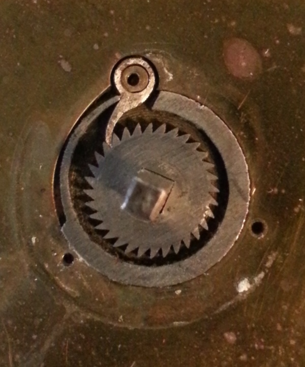

Paul D. Trombley
Cool click. I couldn't find it to let down the spring... so that is why the bridge came apart before the balance assembly

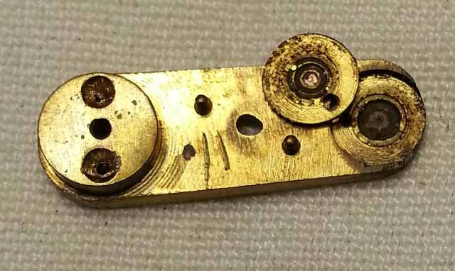

Paul D. Trombley
Under the plate. The only identification marks of any kind are 2 2 5 on this plate... and 2 5 on the bottom of the other plate.

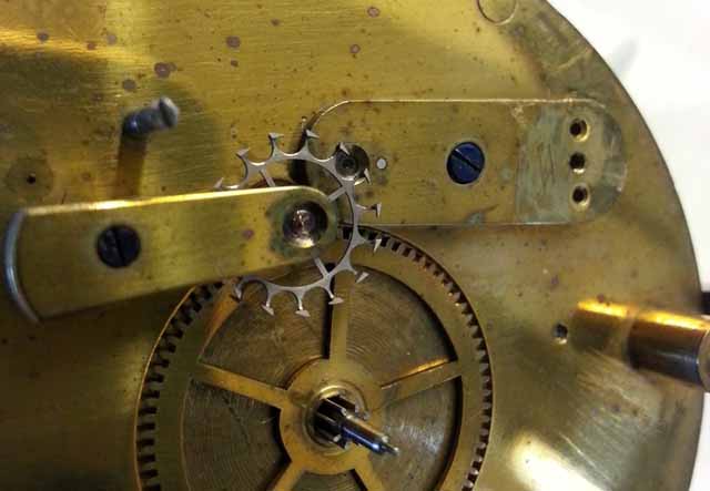

Paul D. Trombley
Interesting that the lower balance jewel is contained in a base that is keyed and screwed to the top plate. The balance assembly is a stand alone unit.

ain't been off in awhile... It was interesting to find the balance jewels are capped bringing this watch up to 6 jewels.
Several of the components had these parallel match marks... The best I can figure is that they mean "this side goes to the plate".

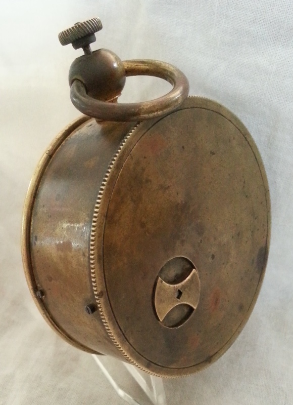

Paul D. Trombley
William,
My best guess is also in that 1870-1880 time frame. The case does not have gimble mounting so I think the marine application is out.
It is actually quite friendly to carry and works great held in the hand or laid flat on it's back.
It's found a new home on the kitchen island as a stove top timer.
I'd love to hear some one chime in to say they recognize a unique attribute like the click, the stop works or the balance and escape to help narrow down the time frame or even a watch maker.
I totally forgot to get a photo of the front side... the mechanism for resetting the hands to zero is genius in it's simplicity.
