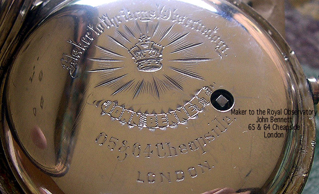

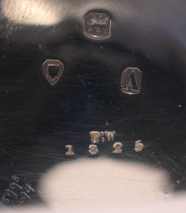

Mike LaForestI just noticed this thread and thought I would add a few cents worth. Sir John Bennett bought ebauches from Switzerland and used cases made by English artisans, operating from his jewelry store at 65,64 Cheapside, in London.
This store location was destroyed by German bombs in WW II. Anyway, Roger, getting back to your original question, the letters "JB" do not refer to John Bennett. I have pictured below an example of one of his watches showing a typical case. Note the case makers initials: 'PW' (Phillip Workman). The letter dates the case to 1876.
September 10, 2009, 10:07
Mike LaForestFront lid of the hunter case:
September 10, 2009, 10:15
Mike LaForestStylized dust cover shows Bennett's gift for showmanship and promotion.

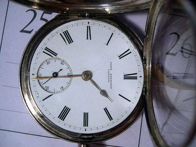

Mike LaForestThe dial...
September 10, 2009, 13:57
Jerry FreedmanThe watch appears to be a "Liverpool Runner". It does not look good enough for that case. I wonder if it was a later marriage! Anyone else with a thought on this?
