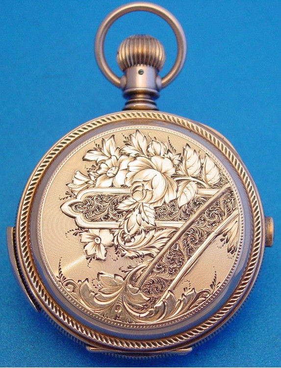

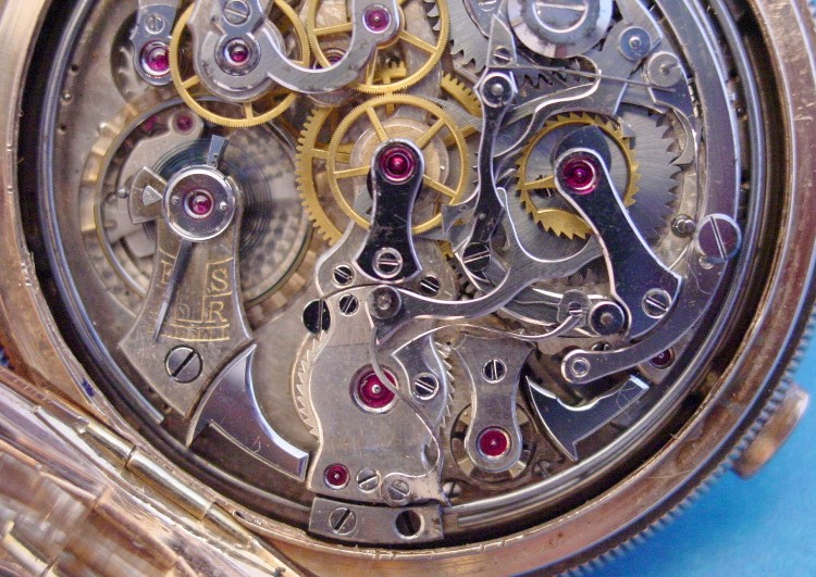

Does anyone know the maker of this watch. I am not about to pull the dial to see if there is any maker name under it. Also is this a 32 jewel? Thanks for input
August 09, 2007, 16:31
Robert V. JonesNice 14K Hunting Case

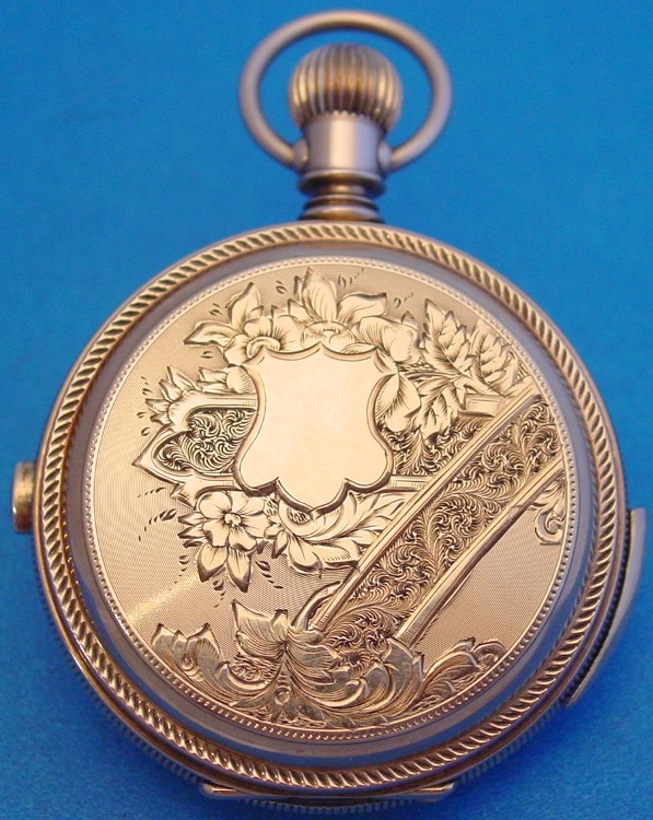

Robert V. Jonesother side

Gene PianoHi yes a nice hi-grade movement, could be Agassiz, Meylan, LeCoultre, but pulling the dial is always good, although a lot were unsigned under the dial. Looks like a nice American recase. Regards Geno

Ethan LipsigI am betting this is a Le Coultre. Notice that the hammer for the inner gong is detached from the main repeater bridge. That is a fairly unusual layout. None of my 4 minute repeaters by Meylan (2), Touchon, and Koehn have such a detached hammer. Three Le Coultres shown in the 2007 Complete Price Guide have such a detached hammer, the 32j on page 516 and the calibers 43 A and B on page 517. The only other repeater I can find in the 2007 guide with a relatively similar detached hammer is the Non-Magnetic Watch Co. repeater on page 532, but that watch has an unusual main repeater bridge. It is hard to see the bridge in your watch, Rob, under the forest of chronograph parts, but it looks more like the Le Coultre. When you also consider that Le Coultre was one of the biggest repeater movement suppliers, the odds that it is a Le Coultre go up.

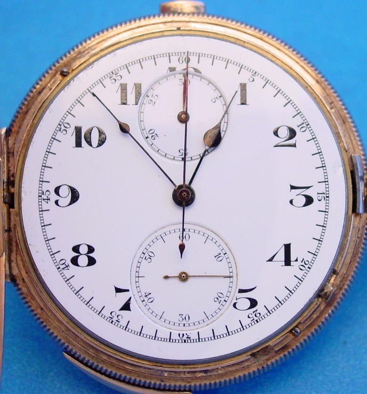

Robert V. JonesHere is a picture of the dial. THe watch measures 53mm across the case without the pendant or slide or chrono button. Thanks for all the help to. Gene welcome to the 185 site I am also curious as to why you believe this is a recase??

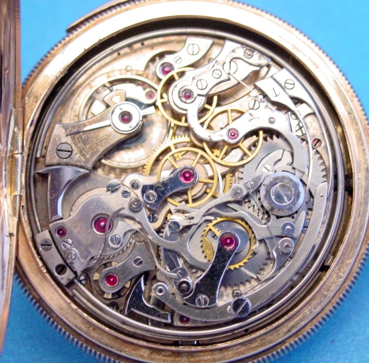

Robert V. JonesHere is another picture of the hammers

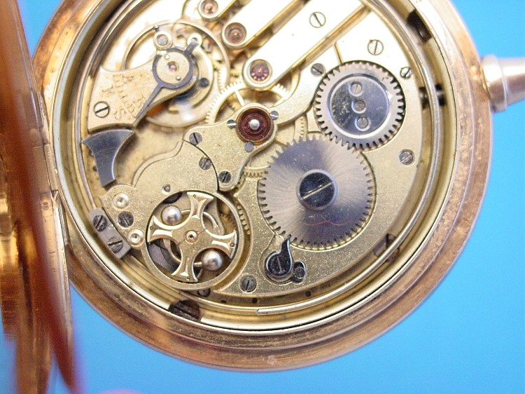

Mike HarroldI've been on vacation, and only occasionally in contact with civilization. Regarding LeCoultre, doesn't this repeater have some sort of centrifugal regulator, that potentially rules out LeCoultre? I believe that I am seeing such a regulator. While my knowledge of repeaters is limited, I do not readily associate this device with LeCoultre.

Robert V. JonesHey Mike that one does not have a centrifugal regulator. This one does as you can see. Another one I picked up.

Also, are you sure it doesn't have a centrifugal repeat regulator? The jeweled cock between the repeat mainspring and the hammer on the right seems to be over that type of regulator.

Cooksey ShugartHello Rob, your repeater is a Le Phare movement due to the centrifugal styl governor. See page 519 book #24 to 27.

Gene PianoOk Robert asked why I think it's a recase. First of all look at the picture of the movement in the case. The base of the gongs shows a crude cut out, look at the amount of space around the gongs , unsymetrical and wat to much room at the top. Next clue, the slide is sloppy and it would not have a ribbed pendant to slide over, that area would be smooth or lightly engraved. The style of the case is typical American drum, and would not have been appropriate for this movement. I can't see the cutout for the chrono button, but I would bet that it looks sloppy. Regards geno

Gene PianoTake a look at the picture of the movement of the second repeater and see how nice and symetrical it is and no notch out for the gong base. Sometimes the gong base has been notched but it would be a very tight professional fit. So Robert without seeing it in person I would bet 90% yours is a recase, it's still a nice piece. Thanks for the welcome. Geno
