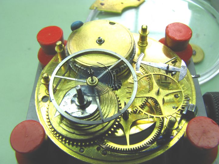

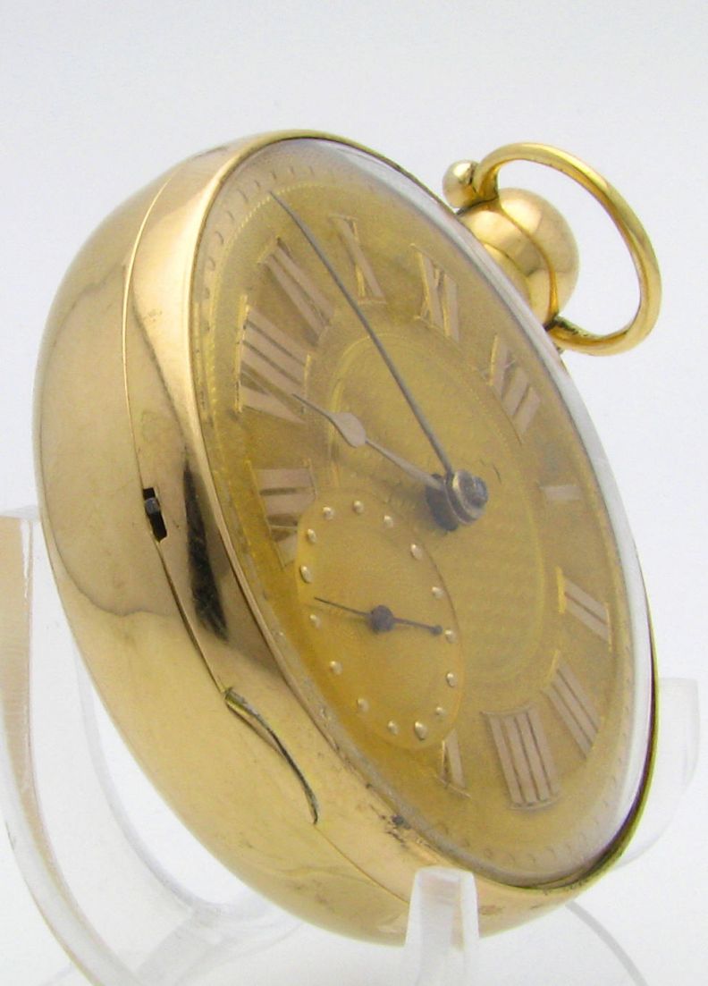

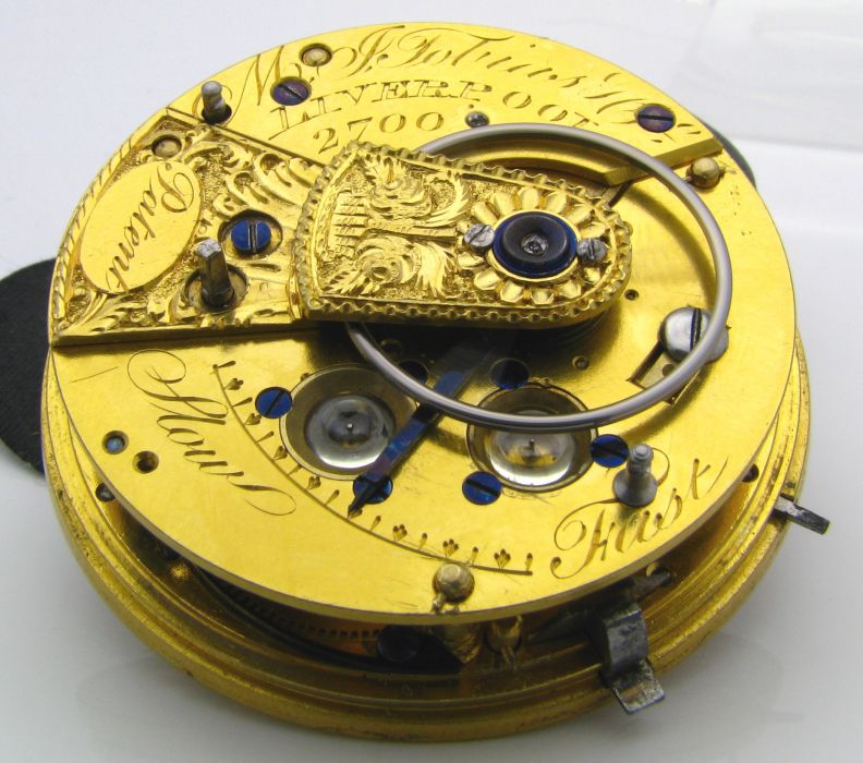

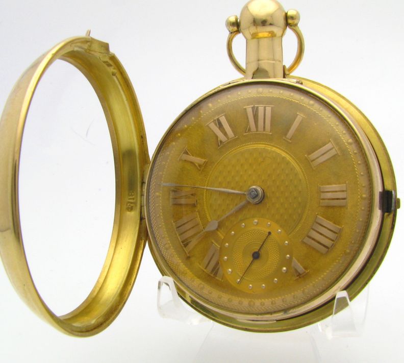

Here is a very interesting pair cased Tobias I have been working on, check out the rack and pinion escapament first I have seen.
Also note the 15 gold dots majors at 5 for a 15 second sweep hand.
If I was to have a old watch in my collection this would be the one of my top choices.

Chris Abellnote the stop works on the bottom, the lever presse against the pallet

Jerry FreedmanI own a pair cased rack lever by Roskell. An easy way to spot these watches is to look for the sliding screw under the balance wheel. Not all rack levers have the screw, and not all have 15 second second hands. The shape of the end of the lever is another indication of a rack lever.

Just look at the 'In your face' size of those train jewels too! And they'll be hand made too, how long must those have taken to grind and polish.
That's also in addition to the Diamond Endstone on the balance!
What a gem!
Good shot of the barrel, chain and Fusee for anyone that's never seen these before too.
