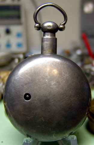

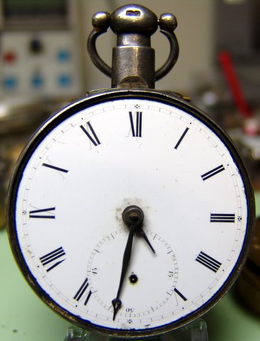

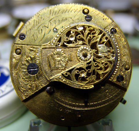

Just picket up another fusee to play with, this one is marked Edward Manley London, in Loomes it looks like he was in business in 1808.
Can John or someone interpret the case marks for me, I never can decipher the year code. It looks to me Sterling, London. Also any idea as to the case maker?
The watch seems like it should run with cleaning, it is a verge movement.
It is missing it's outer case & I will need a new hour hand & second hand.
Anyway I only paid $30.00 which to me was a good deal.

Movement
mov

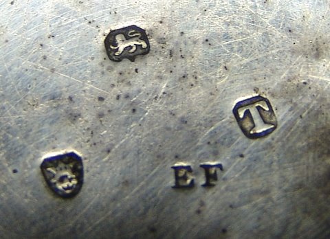

March 14, 2009, 19:04
Case marks

March 14, 2009, 19:38
Gerald Zimmermann
You are right with Sterling, London
The year is 1814
This is the only 'T' in a shield with clipped top corners.
(Think we share the job: i chech te numbers and you dig out the names. Great respect!)
Gerald

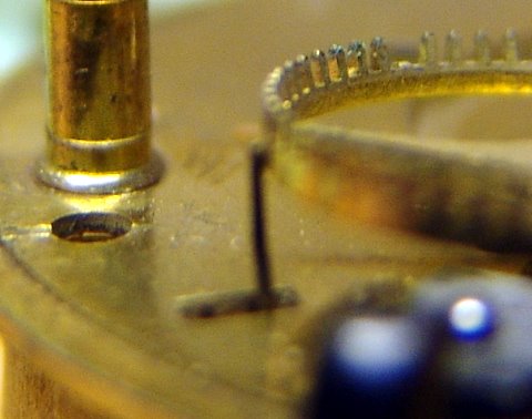

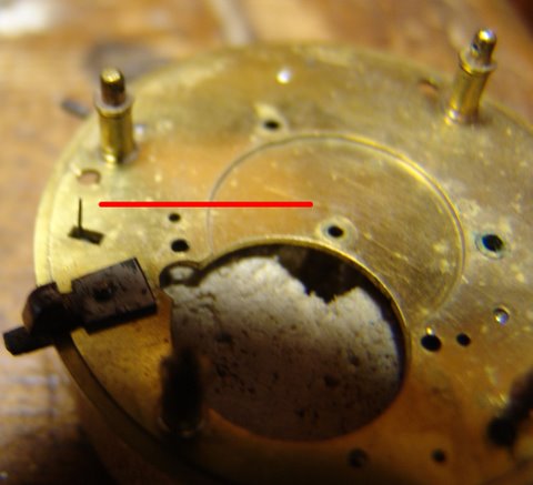

I found something on this watch that I haven't seen on other fusee that I have worked on. Does anyone know what it did, I noticed it when taking it apart to clean.
There is a small wire size pin that stick up into the edge of the movement.

Another view where it comes up into the movement.
pin02

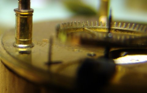

March 14, 2009, 19:56
This is where it attaches to the back under the dial
pin03

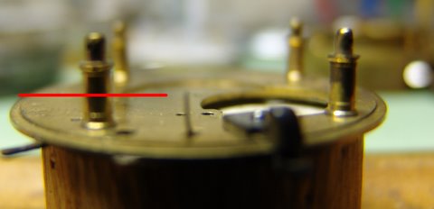

March 14, 2009, 19:58

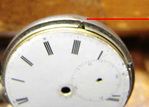

Then last, in the prior photo there is a bar that then sticks out past the dial, this then goes in a grove in the case.
I haven't seen this in other watches, and I can't figure out what it does.

Gerald Zimmermann
I think it is a broken wire from a second stop mechanism which original stopped the balance in one position of the lever. So it may be an early doctors watch. I have not seen this on a verge but this start stop device is often found on center seconds movements at the end of the 19th century.(english lever).

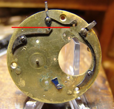

March 14, 2009, 21:59
Thank you Gerald
Looks like you are correct, I have never seen this. After your post I stuck the second hand wheel back in & sure enough that is what it does. Now I will have to be sure to put this back together.
pinopen
March 14, 2009, 22:00
The 1st photo although a little blurry is the pin in the run position. This photo is with the lever moved into the stop position.

March 15, 2009, 06:01
John Woolsey
Nice catch Tom, certainly a stop watch arrangement, which in these cases is quite literal!

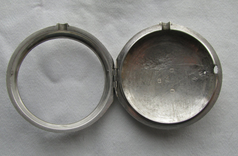

The casemaker is probably Edward Feline Jnr, 3.Georges Row, City Road. 1st reg'd 'EF'(in a shield) 25th July, 1794.
He then moved to 8,Pittman Buildings, City Road on 13,Oct 1795.
29th March 1814, he registered the incursive mark on your case, at 7, Serle Row, Bath St, St Lukes.
8th Jan 1821, again registered the same mark, but back at his old premises at 8,Pittman's Buildings.
Finally 4. Sept 1822 moved to 2, Gloucester St, Curtain Road.
EF incursive is only listed to this maker in my book.
Tom, let me know the diameter of the hour wheel, and the size of the square on the cannon pinion for the hands.
Also let me know the radius from the cannon centre to the inner of the numbers, and the outer chapter ring.
Also let me know the diameter of the seconds pinion and the radius of the chapter.
I can probably fix you up with either Gilt matched pair, or possibly Blued steel.
Seconds not sure, they're getting like hens teeth now!
It'll be a much later hand if I have one, but better than none at all.
Both type hand sets will most likely be 'Spade and Poker' rather than the 'Beetle and poker' style.

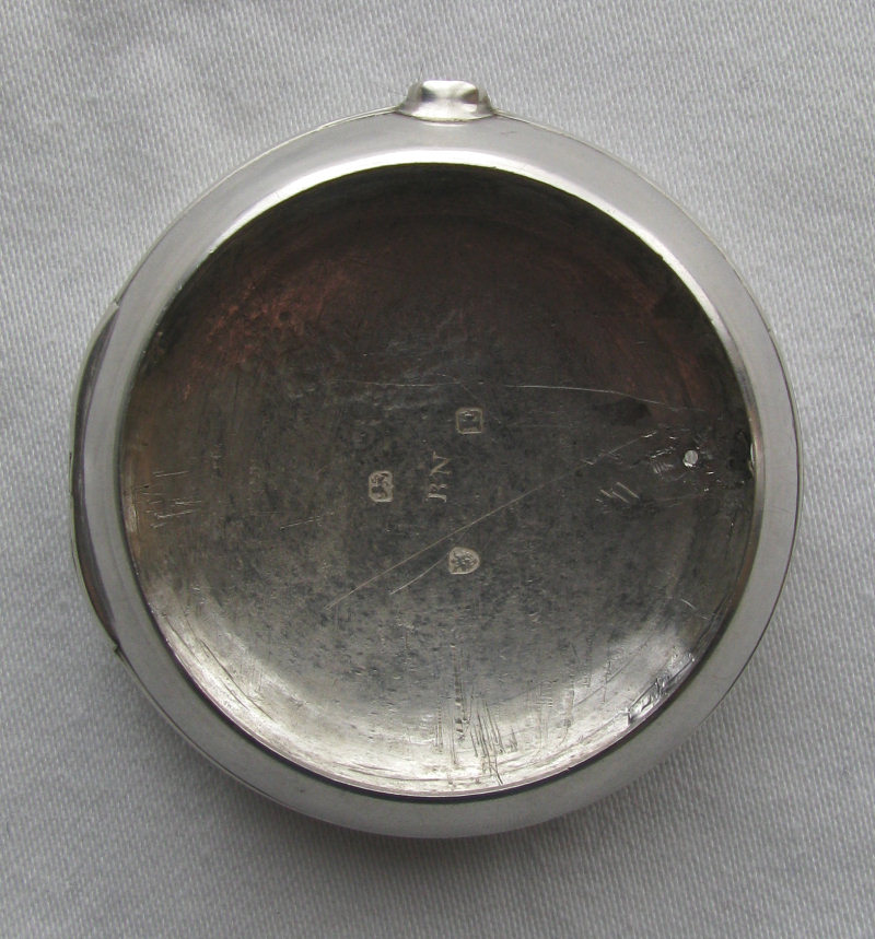

I have an outer case spare here, I'll check see what case diameter it will take.
It also has a neck to suit a round pendant rather than the oval type yours has, but it's a thick band so you may gat away with altering it.
It's Sterling silver hallmarked for London 1800.
Needs a small tear soldering plus a release button and sping catch making.
I'll post it on to you if you think you can use it!
Photo's of case below!

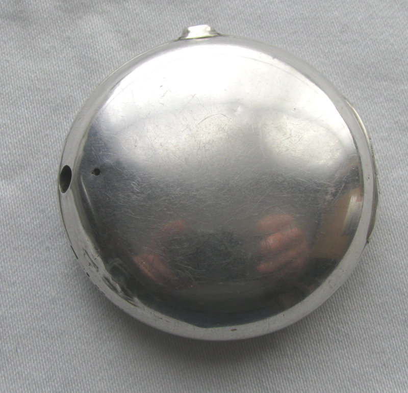

Outer pair case

March 15, 2009, 06:04
John Woolsey
Open case
Case opened
March 15, 2009, 11:48
John
Thank you very much for your generous offers, I will get all that information to you.
Also, do you have any fusee chains, unfortunately this watch had stopped fully wound & when trying to let it down it slipped & the tension broke the hook that attaches to the fusee. If not can you repair these? I checked the extra chains I had & they are two short. I will send you an email with all the information & the length of the chain in case.
Also can any of you tell me why they made these with the stop works? What purpose did they serve?
Thanks again
March 15, 2009, 12:57
Gerald Zimmermann
They were used by doctors to mesure the heartbeats of their patients.
stop the watch at 0 seconds, start it again and count let's say 20 heartbeats, stop it again. You can calculate the beats per minute exactely.
In later times when watches kept time better than verges, start stops were used to synchronize two watches.
Sorry to see on your pictures that your watch needs a 'dentist' too. The second hand wheel misses one tooth. Lot of work to do, but this watch is worth all of it.
