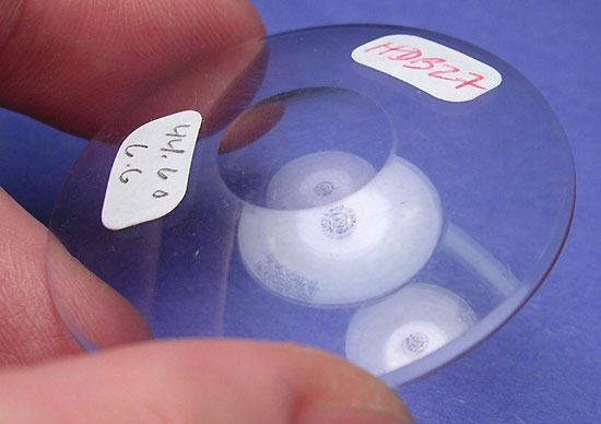

No doubt there is a simple answer to this but I do not know it. Why does the crystal on this watch have the small concave (inwards facing) bit in the middle. It is about 11mm dia and gives a mild magnifying effect. I see no reason why you would want the end of the hands to look bigger so there must be some other reason. Can anyone explain please. Had fun getting the picture and in the end did it by making the crystal dirty. It is now clean again.

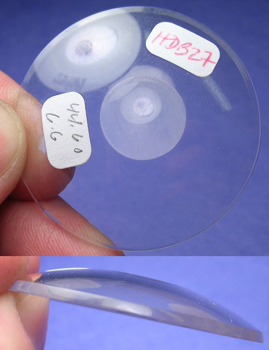

Dave CoatsworthYes, if you look at some of the older ones that I have for sale, they are higher dome.  Also, the 'bullseye' has been ground instead of molded as you see in the later low-dome bullseyes.  This is consistent with Lawrence and Ed's description of how these older bullseyes were made.  Often, as in this photo, the bullseye is not exactly centered, either.

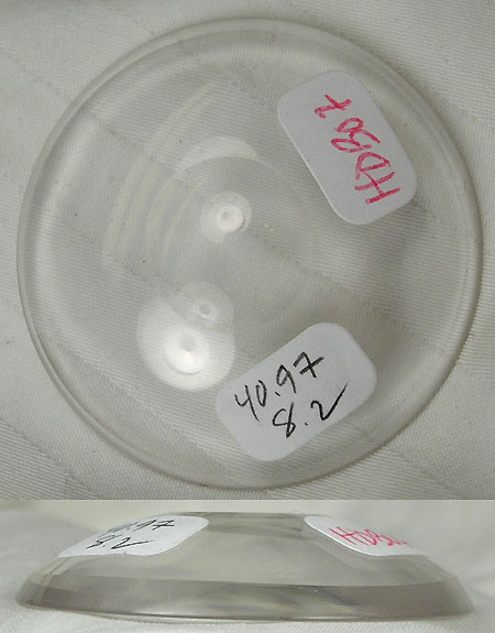

Dave CoatsworthI managed to capture a few photos that show the bullseye on these old crystals better.  In this one, I caught the reflection just right so you can see the grind marks.
June 09, 2007, 12:17
Dave CoatsworthAnother view without the reflection off the bullseye...
