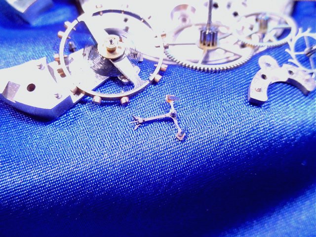

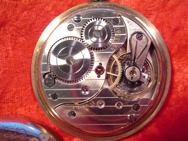

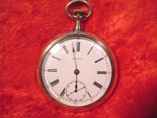

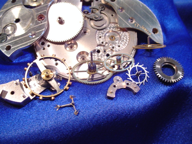

Here is another recent find, It is marked Decimal and is really a nice well made 17J watch which lead me to wonder if it is in fact a higher grade than the normal Swiss junk. I show a picture of it partially disassembled and in it you maybe able to see that the pallet stones are blue Sapphires?, the machining is far better than normal and from what I would guess looking at the plates appears to be a Omega watch around 1900-1910 would be my guess made for Canadian/UK market?. Any ideas?

p1
March 10, 2004, 14:19
Chris Abell
p2
Chris A
p2
Chris Abell
p3
Chris A
p3
March 10, 2004, 14:21
Chris Abell
p4
Chris A
p4

Chris,
I've worked on only one Omega pocket watch that was made around the 1920's to 1930's. It had features very similar to Elgin and Waltham. The pallet cock was copied after Elgin and the setting mechanism was very similar to a Waltham.
Your watch looks much nicer! Does it have a steel escape wheel?

It has a steel escape, and gold train, the plates look like Omega especailly the cock, well no doubt our resident experts will soon respond before I go off making assumptions.

My guess would also be Omega, particularly based upon the shape of the hairspring stud and the shape and location of the ratchet click. Unfortunately, I'm not familiar enough with Swiss watches of that vintage to be able to say with absolute certainty.
