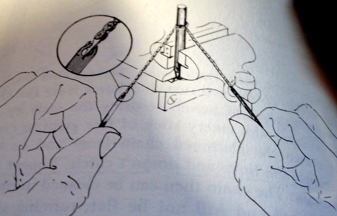

John & the other Fusee experts might offer better advice but I follow what is in The Watch Repair Manual by Henry Fried.
Page 362
"The chain is lubricated by wrapping it a full turn around a steel punch, placed upright in the bench vise & held as shown in Figure 13. Before grasping in both hands hold both chain ends in one hand while the other applies some mainspring oil above the junction of the wrapped around chain & the steel punch. Then with both hands holding an end of the chain, thrum it back & forth . This allows the oil to reach into the various corners of the chain. Wipe off excess oil by running the chain through a folded clean tissue with out drawing any lint from the paper..

What I would say though, is take a carefull look at each and every link, because they all need to roll away freely from each other - you'll probably find many of them are seized, and the chain will mostly stand out like a stick if you pulled it straight and held it out in front of you!
All those seized links need to be freed off before using Fried's method of cleaning, otherwise you could end up with snapped pins, a rod like that shown is too extreme a radius to pull a seized chain around.
Generally I give them a few cycles in my ultrasonic to get them well buzzed and really warm, then oil and work the links free - then use the rod to finish working them loose.
After cleaning again, I lube with clock oil then wipe clean with a lint free cloth - an oil film stays put inside the links and pins.
