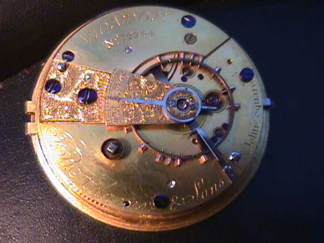

Would anyone be able to identify this movement, and have any information about who manufactured it? Thanks
Movement

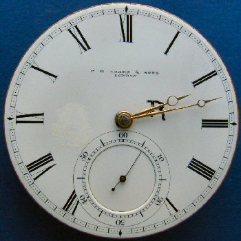

Would a photo of the dial help identify this watch?
Dial

FB Adams & Sons of 21 St.Johns Square, Clerkenwell, London are listed in the 1861 "Watch Clock and Goldsmiths Trade Directory" as Wholesale Watch Manufacturers.
"Watchmakers & Clockmakers of the World Vo1ume 2" by Brian Loomes says that Francis Bryant Adams was born circa 1821 and continued at least until 1875
The style of the dial means this movement was made sometime between 1850 and 1870.
I have seen a few Swiss fakes signed "Adams" but this one looks English. Does it have a fusee ?

Yes its a fusee movement. In my opinion the dates for F. B. Adams are:
Francis Bryant Adams London (Clerkenwell) Apprentice 1792 St Johns Square 1809-11
Son- Francis Bryant Adams Apprentice 1821 Master CC. 1848 1828-75

With apologies : Typical of the English 1860's to the 1890's and later as I am sure you know.In your picture it looks like 3/4 plate,1880 or so...likely built by 5 or more people.
On A personal note...A 3/4 plate could kick me in the head I could only base it off of pictures...yours looks like a 3/4 plate..if it is a full plate please show me what i missed and help me learn.(no change in time frame)
A great watch in my mind.Sorry if I am out of line as a beginner.
Did you know Francis Bryant Adams & Sons received an 'Honorable Mention' at the Paris Exhibition of 1855.
Out of curiousness what would make one suspect this of being swiss?It looks very late 19th cen English to me.

I have a very similiar mvmt. Nicely made and notice that the plates are screwed together, a feature not seen on lessor quality movements...Mine has cap jewel on the escape wheel. Also rather large at 50mm...Same dial.. Wayne your's is missing the regulator??

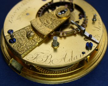

Yes, the first movement shown is missing the regulator. But here is a second one, that does have the regulator installed. Thanks. All the information I know about the Adams watches was provided by Mr Frank Menez, a Trustee at the Charles River Museum of Industry, and an expert in European watches.
FB Adams

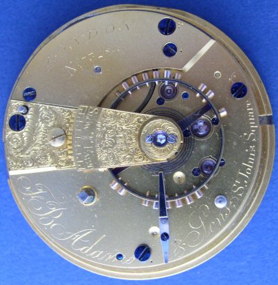

John Pavlik
They are a very nice movement - with lots of modern features. The hairspring holder details are very remarkable.
FBAdams-1

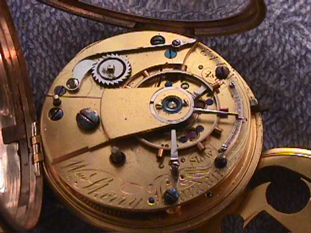

Wayne,
Here is one of my favorites. The detail work on the set-up spring, the regulator, just every detail is finely finished. The 20 size watch is signed Wm Skerry London. Serial #147 and dates to the 1830's..It also has a unique bridge for the lever. It does not pivot in the piller plate...but has it own "hanging bridge", much like and escape wheel does... Makes assembly much easier..

Very nice movement. I will have to look up Wm Skerry and see what information there is about him. Thanks for posting the photo.
